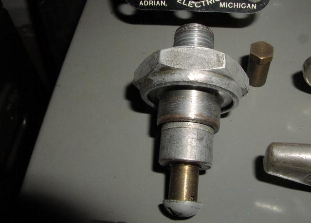

It is definitely a dual-chex. The gauge only has off or on. After a month of owning the car the gauge started to change from off to on and then mostly off. I'm hoping it is not low pressure only a dirty connection or sending unit. During cleaning of the sending unit the connection at top of the sending unit has the two threaded pieces. in additions to the the threads that attach the unit to the block. The top piece has the wire attachment and that piece also has a collar sleeve that is threaded and adjustable. Is there an adjustment on the top of the sending unit or an amount I should tighten the collar down too? I will post a picture later this evening.

05-24-2017 @ 6:43 PM
Posts: 34
Joined: Feb 2017
Picture of sending unit

A while back someone reproduced the Dual-Chex. It is possible you have a reproduction?? I do not know the difference, in appearance, between the original style and the reproductions. Although it would appear the sending unit may have adjustment I doubt it! If it were adjustable there would be locations for adjustment tools (slots or hex) Maybe someone who knows can chime in or contact Dave Rehor to see if he is aware. I would not make any adjustments to the sending unit or the gauge (2 on the back) without knowing the procedure for adjustment and putting a mechanical gauge on the engine (remove the plug under the sending unit). To see if both a mechanical gauge and the Dual-Chex agree on the engine oil pressure. Ford engines typically have very low oil pressure at hot idle (10# or less)

If anyone has an original, would you share a photo with the club.

This is supposed to be original 32,33 & 34

Interesting, the one on my roadster, is the same style, only modern looking.
