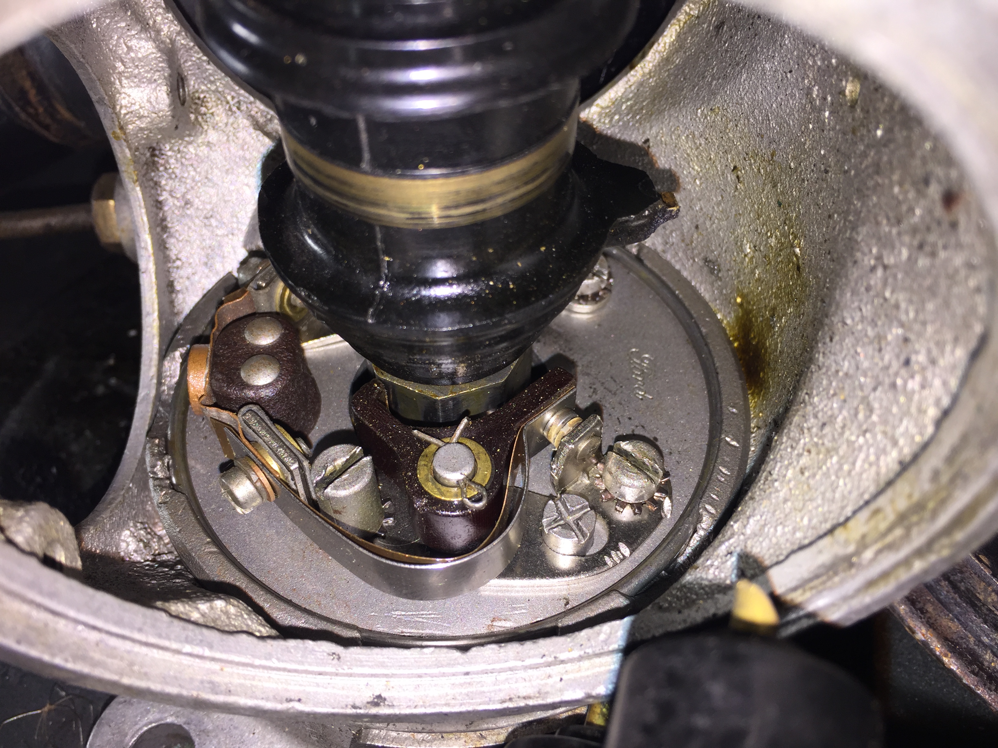

05-15-2017 @ 3:47 PM
Posts: 18
Joined: Sep 2016
Here's a good pic of the points on the passenger side of the distributor. You can see the gap. Everything looks fresh.
