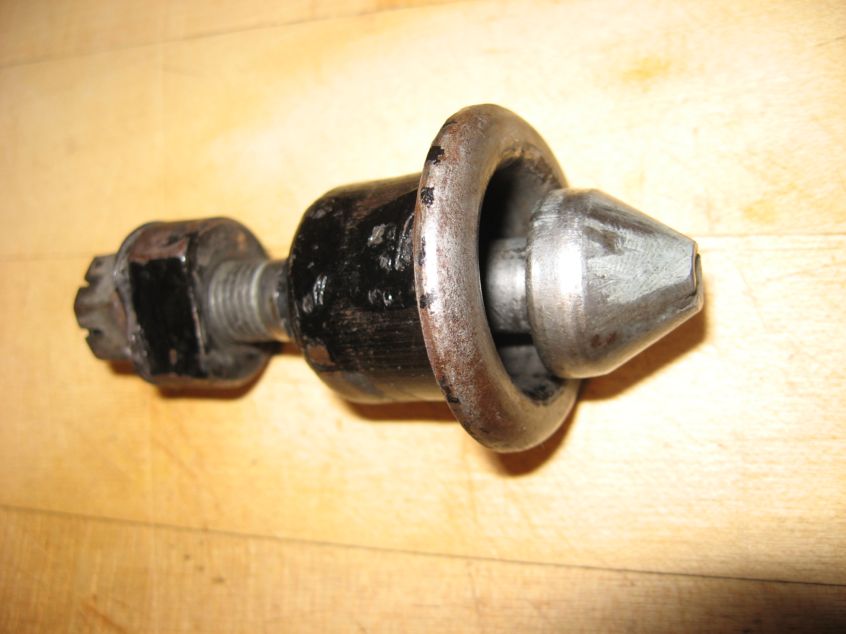

Len47, I was looking for a totally unrelated part in the attic and I found this latch assy. It came from our family basement many years ago. I compared it to my 47 sedan and seems to be identical. The cup looks to be painted gloss black. The spacer with a flat surface is also gloss black. It does appear that the part was dipped since there is sort of a bubble on the spacer. The bullet is un-painted. Not sure what plating used back then but could be clear zinc, Cad or Nickel? Just another data point to confirm what others have observed - Bob

Thanks for all the replies. woodiewagon46 - this '47 is actually a quite virgin, original multiple-Rouge award and Rouge Medallion Award recipient that not only I but multiple judges from multiple EFV8 Meets/Regionals missed the fact the hood spring and guide were missing from the dowel. I guess since it's over the head it's easy to overlook when your so focused on water pumps, engine patina, etc., etc. I am more than a bit embarrassed by it myself quite frankly and it's something I never thought or needed to look at when at Meets. To answer your other question, I have used the technical adviser on one occasion 3 years ago after exhausting all resources to obtain the answer to a relatively obscure point of detail that my legwork in advance of taking advantage of his volunteered time and free advice was greatly appreciated and garnered a more comprehensive set of data than I expected. I think with the replies herein (expecially TomO and Bob-93021's) and the data I've been able to gather outside of the Forum - including a non-rusted hood with original paint from a '46 found yesterday about an hour from here - that I have adequate, compelling evidence and data to move forward should I choose to go the paint route. At this point I plan on installing the used parts as is for the next Meet and Rouge judging pending final without-a-doubt confirmation.
It seems I learn so much more about many other related and non-related subjects on this car - and others - when I get on one of these journeys to answer a question like this about a simple subject. Part of the fun to me - I'll get to the tech adviser if necessary but only after I've turned over ever leaf I can find.
I am confident the dowel was left bare with a cadmium plate, and the guide was the proverbial gloss, 'er, 'ah, satin, 'ah, semi-gloss black. The spring remains a bit of a puzzle but given the used one now in-hand and the one on the hood referenced above both have sparse remnants of black paint on them, and TomO's original Lincoln shows a likely-dipped spring, that the preponderance of the evidence more than suggests this was originally black.

Thanks Bob for the great pic - very helpful to me and greatly appreciated for your effort to fish this out of the attic as well as weigh in with your reply!
