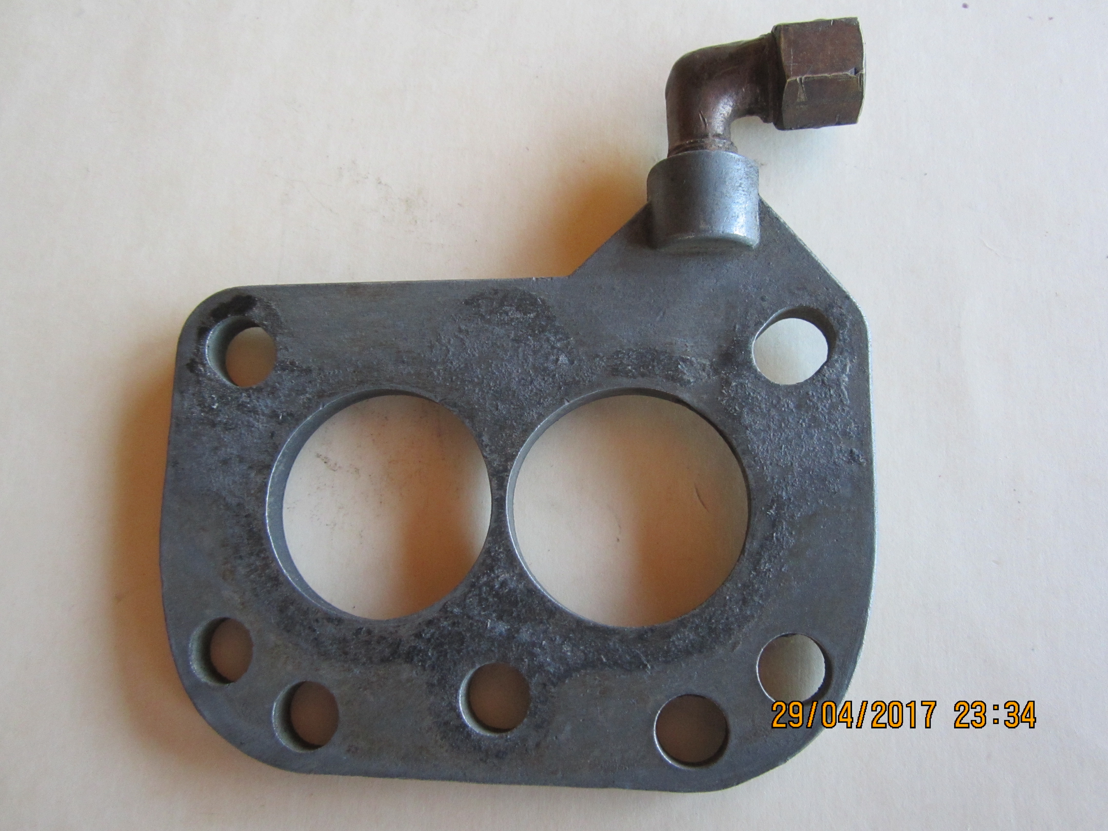

Hello,
I am rebuilding my Stromberg 97 carb for my 37 Fordor. There is a spacer of sorts that was between the card and intake manifold. I have no idea what this is for nor whether I should keep it on the engine. Any clues??? The right angle copper piece has some kind of opening in it which probably feeds through an opening in the inside of the spacer.
Is this a stock piece? Pros and cons of using it?
Thanks,
Gregg

05-01-2017 @ 11:42 AM
Posts: 1301
Looks like a vacuum port used for a operation of a Columbia rear end. Was there any plumbing connected to it?....
Stroker
05-01-2017 @ 12:37 PM
Posts: 1460
I believe MG is correct about it being a vacuum source for a Columbia, as they required a large "volume" of air-flow to operate the large shift cylinder on the axle . My Columbia has an identical spacer. The only "con" to using it, is that you have TWO gasket surfaces to make leak-proof instead of just one. Unless you need a lot of vacuum-flow to operate something, it is rather pointless to keep it.
42merc
05-01-2017 @ 12:44 PM
Posts: 127
Joined: Dec 2010
Me thinks it probably was the vacuum source for a South Wind gas heater.
1937sedandelivery
Posts: 501
Joined: Jul 2014
Thanks for the swift responses. Nothing was connected to it, so it was probably causing a vacuum leak. I haven't started the car since I bought it a month ago. Still working on getting everything in shape for the big Day. This part will go into my bag of "stuff" for now. I believe the rearend in the car is a regular stock one, but will look into that also.

ken ct.
05-01-2017 @ 1:04 PM
Posts: 1513
42 Merc is correct,don't need it. You might need shorter carb mount studs if carb wont tighten up good to manifoldPO may have installed longer ones to use the plate. Normal hardware stores carry carb studs.ken ct. You also get a little more ommph from a 48 carb as its a little bigger internally, jets,power valve are bigger than in a 97. ken ct.

1937sedandelivery
05-01-2017 @ 9:38 PM
Posts: 501
Joined: Jul 2014
That may be the case. My car doesn't have a heater now, but it appears that one used to be installed. More investigation is needed on my part.
And yes, the studs are too long. For now I am using a 3/8" nut as a spacer. Eventually will replace the studs with shorter ones.
