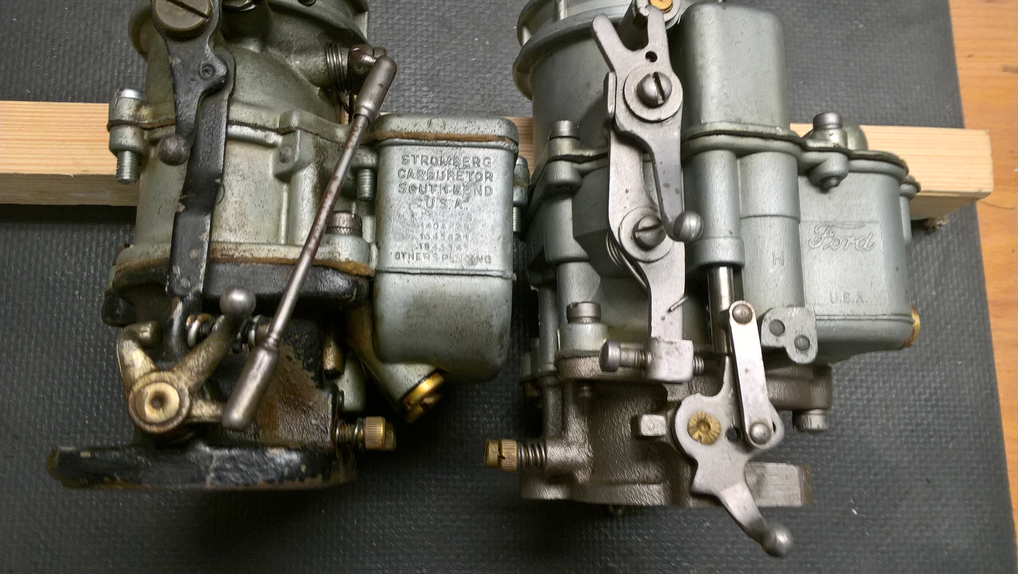

I wish to know if there is differents linkage rods if I use a Stromberg 97 carb or a Ford model 59 carb?
As I can see it seems to be different lenght of the rod depending of which carb I use.

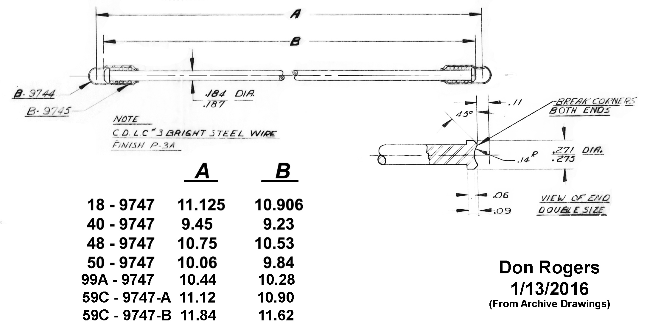

Jehn, The length of the rod depends upon many factors including the firewall design and its distance to the carb, as well as the accelerator linkage. I am attaching a drawing that I made showing a few of these lengths.

At the moment I use a Stromberg 97 carb and the rod is about 10 1/2" from end to end.
The other day I tried with a Ford model 59 carb and the rod was to long and should be about 9 1/4".
I have seen that different rods are available but no one about 9 1/4".
My car is an -41 Bus Coupe.

The correct rod length for the 41 Ford is 10. 44 according to Don Roger's chart. The original carburetor would have been a 91-99 which has the same dimensions as the model 59.
Could you post a photo, so we could make a better guess as to why the 10.5 rod will not work?
