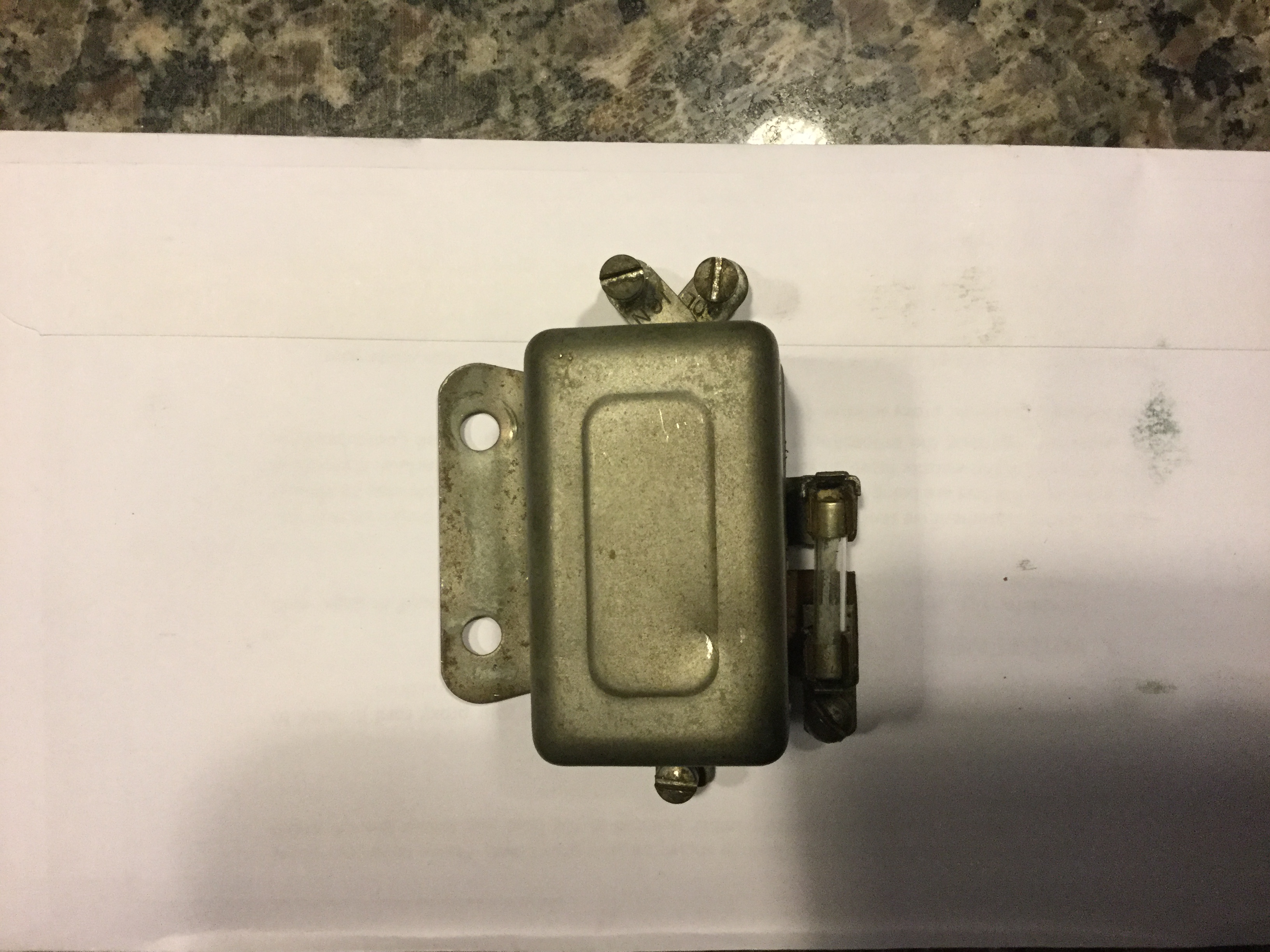

Could use some guidance please. 51 Ford Custom, 6 volt, all stock. New owner. Problem - it freewheels all the time. Downshifting does not slow the car at all. I have read numerous Borg-Warner articles. First question, the overdrive relay pictured below. I believe it is a 12 volt, correct? Will it work for my 6 volt system? The 6 volt relay I believe has only 3 wires to connect; not the 4 this one has. I have wired it per the schematic. I have done the electrical checks and all are good. At the relay, I have power at the ignition, solenoid, TH SW connections and I have power to both ends of the fuse. Put a meter on fuse and checked good. When I ground the SOL/IGN terminals, I hear the Solenoid activate. I checked the solenoid and it is installed correctly. I put a new wiring harness on it. Hoping someone has the solution that doesn't include dropping the transmission. Lol

Your relay might be 6-volt, but not from a Ford - possibly a Studebaker. It should still work OK. How do you have it wired? The wire to terminal #4 on the solenoid should be connected to the SOL terminal on your relay. The power goes to the terminal next to the fuse, the kickdown switch wire to the TH/SW terminal.
If you ground the TH/SW terminal when power is on, you should hear the solenoid activate. Test driving with this terminal grounded to see if you transmission goes into overdrive (and does not freewheel).
Ken

Thank you both, I feel like I'm so close! Ken, the wiring was part of my confusion. On this 4 terminal relay, the IGN terminal is at the end next to the SOL terminal. Heres what I have. I have the SOL and the TH/SW exactly as you indicate above. I have power to the fuse terminal, from the starter solenoid. For the IGN terminal, I have a wire running to the ignition switch.

When I ground the TH/SW terminal I do hear the solenoid activate. I have it grounded and take it for a drive later.
