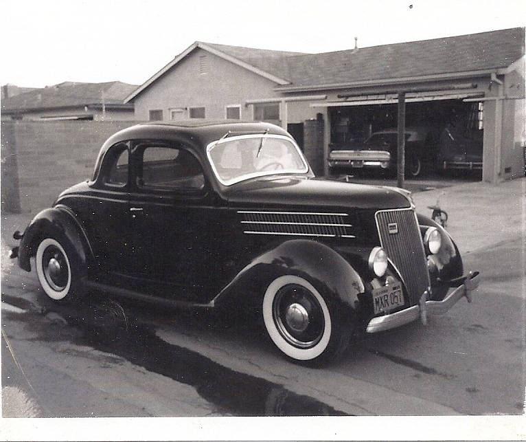

My twice pipes use to really annoy the cops, they would stop me for "dual exhausts" but could not give me a ticket because they did not exceed the noise level. Had a cop try to give me a ticket once for having my gear shift on the left side of the column. I questioned his reasoning, he could not find a passage in the vehicle code that stated anything about the position of a gear shift. He did give me a ticket for "dual exhausts", writing those words on the ticket.
I went to court, pleaded not guilty, went before the judge, told him there was no law against "dual exhausts, just excessive noise. My point being that the new '52 Cadillac's had dual exhausts, the judge responded that I was right, his new Caddy had dual exhausts.
The gear shift lever is still on the left side of the column in my '36 Ford.
