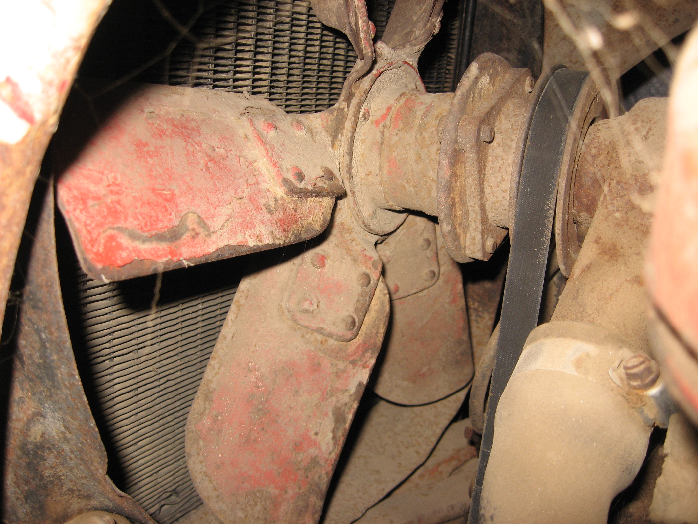

I saw that article in the V8 times and thought it was a great idea. As noted above Carpenter has/had them. Maybe others do. Dr commented on the noise issue and I want to make note of another issue if you pursue a tractor fan. These 6 blade fans were pusher and puller on tractors. Depending on application. Maybe to blow dust forward rather than back??
I have a 8N tractor (love the thing) and it has a pusher fan. See pix - Bob
