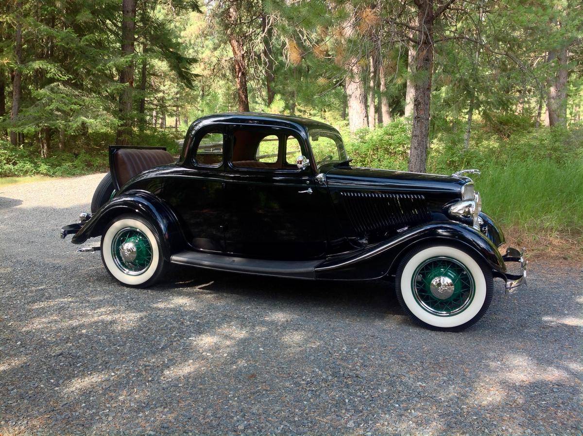

mtelow
03-19-2017 @ 8:15 AM
Posts: 16
Joined: May 2015
Here is a picture

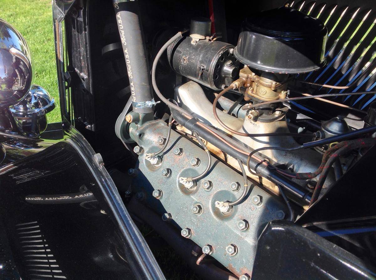

mtelow
03-19-2017 @ 8:16 AM
Posts: 16
Joined: May 2015
Engine

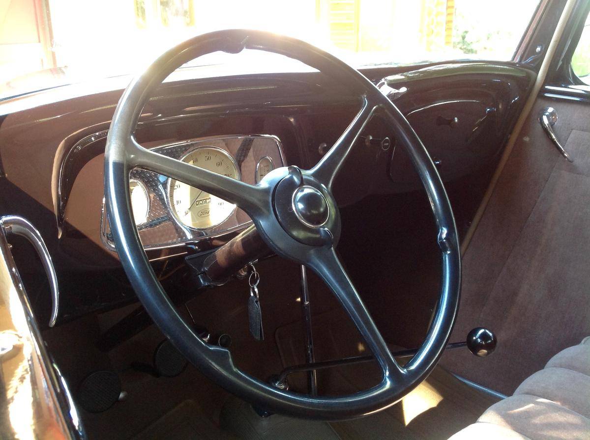

mtelow
Posts: 16
Joined: May 2015
Dash

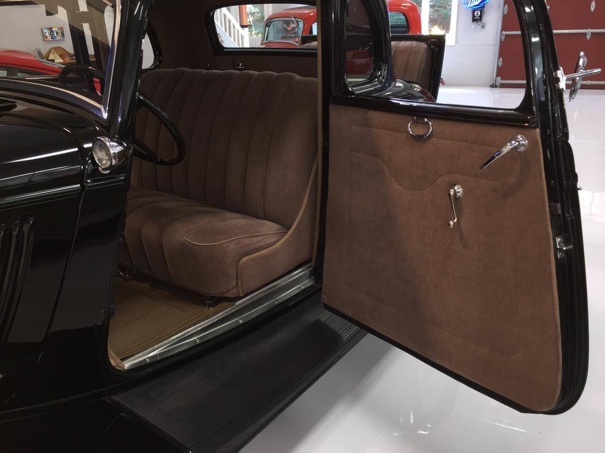

mtelow
03-19-2017 @ 8:17 AM
Posts: 16
Joined: May 2015
Interior

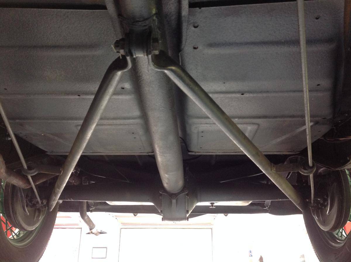

mtelow
03-19-2017 @ 8:18 AM
Posts: 16
Joined: May 2015
Undercarriage
