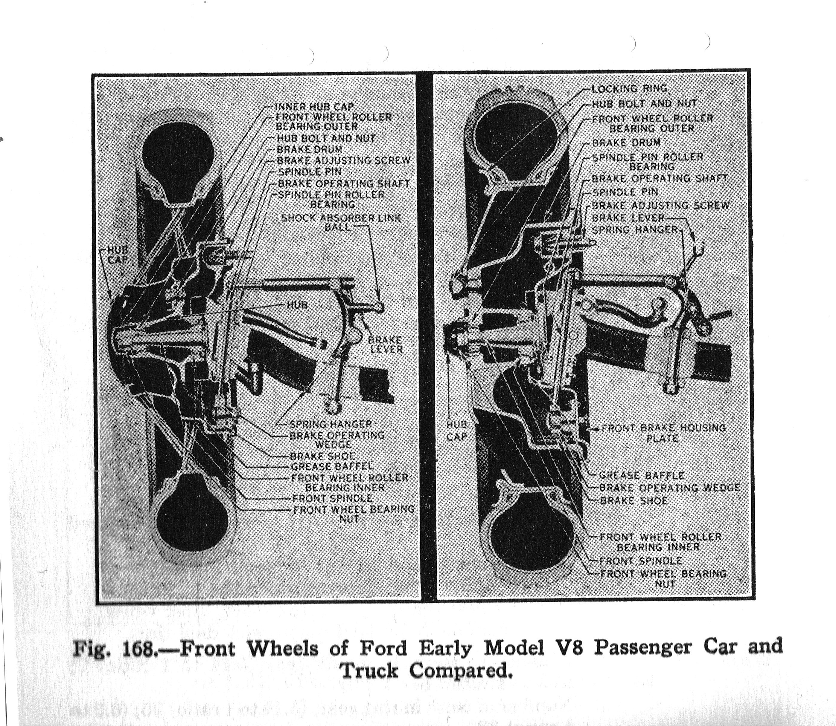

One can "change" the scrub radius by changing the offset of the rim center-line OR the diameter of the outside diameter of the tire. One could conceivably also make a NEW spindle and "tweak" the axle to bring the kingpin inclination angle and the resulting point of tire/pavement contact patch closer or farther from the axis of the kingpin.
Obviously, Ford engineered different scrub radius specifications depending upon the overall front tire diameter which Changed radically in the "early" years with the adoption of smaller rim diameters.
Since a positive scrub radius has a tendency to seek a straight ahead position, less positive caster is needed to maintain directional stability.
About the only negative "effect" experienced by having an excessive positive scrub radius is "bump-steer".
Many years ago, the 1940 edition of "Ford V8 Cars And Trucks" by Victor W. Page contained a comprehensive discussion of this subject. Included was also a discussion on how to change the Ackerman-steering angle by bending the steering arm on the spindle to accommodate different wheelbases on commercial Fords.
