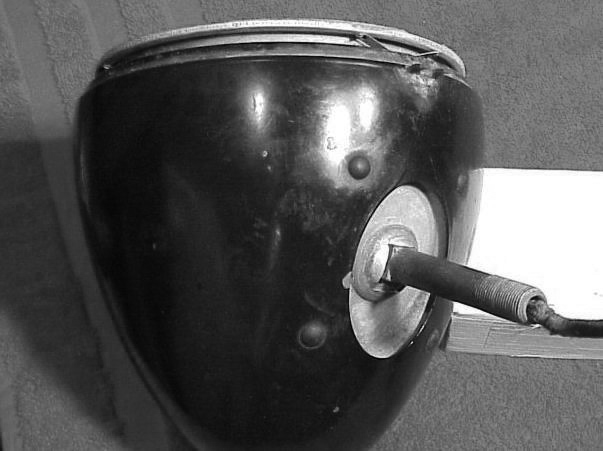

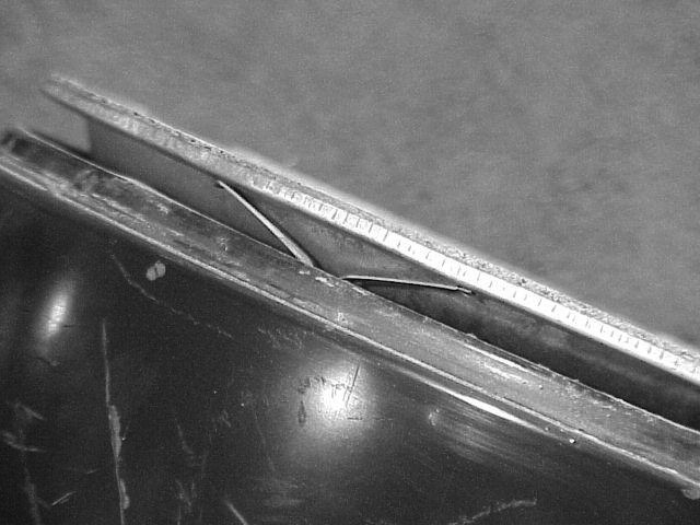

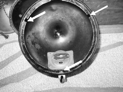

Here are 3 photos showing the notches in the headlight bucket rim and closeups of the spring attached to the reflector and sitting in the bucket rim notch.

2nd photo

3rd
