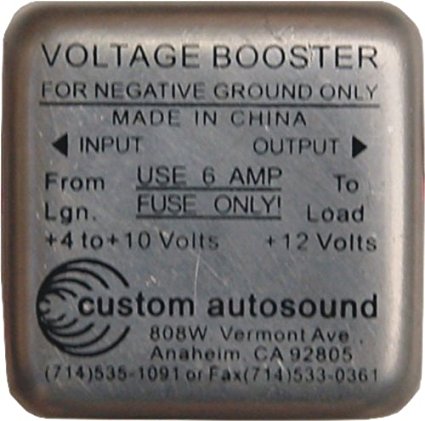

An easy fix is to use a 6-12 volt inverter that boosts voltage and reverses polarity here: https://www.amazon.com/Power-Inverter-6v-Positive-Ground/dp/B004P9NX9C/ref=sr_1_3?s=automotive&ie=UTF8&qid=1488811645&sr=1-3&keywords=6-12+volt+inverter
That is an easy connection but puts out less amperage than a booster that I use here: https://www.amazon.com/Voltage-Booster-6-8v-to-12v/dp/B004P9IS3I?tag=viglink20872-20. But, the booster has to be connected directly to the battery to avoid the need to reverse polarity. That's what I did.
