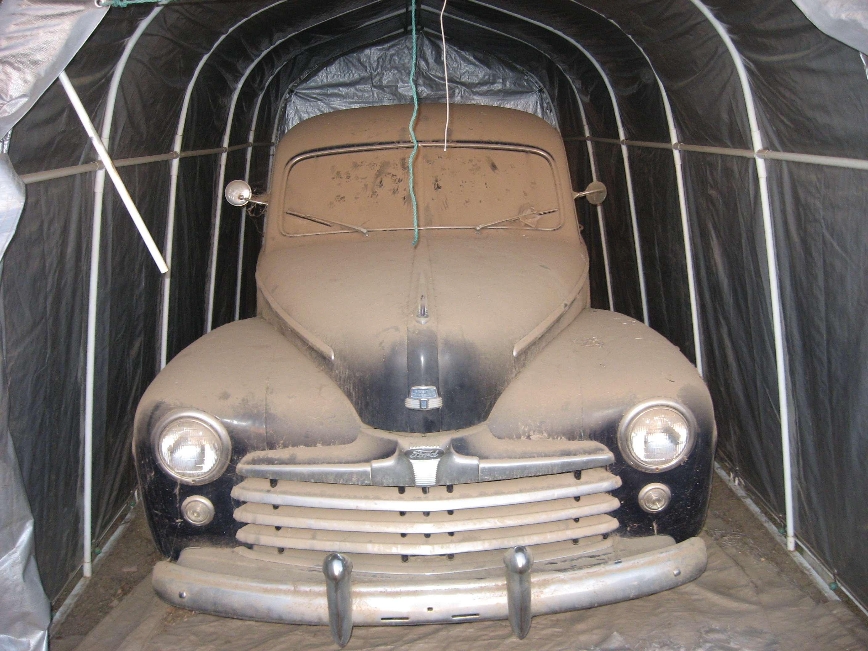

Hello, I recently re-discovered this site. Seem like a lot of knowledge here and polite exchanges. I bought a 47 Tudor a few years ago and it has been just sitting while I work on other things. Finally got some time and first thing was to get it running again. I easily got it started after sitting about a year. I will now slowly sort through a few issues with it. Please bear with me on attempts to post pix of stuff as I learn this site. BTW, I am an early Ford V8 member and totally enjoy the monthly magazine -Bob

Looks like a nice tent find,welcome to the site and happy motering. ken isidor ct.

Nice find! That layer of attractive dust looks like more than a year of sitting! Some great, knowledgeable and helpful guys on here will get you where you want to go quickly.
