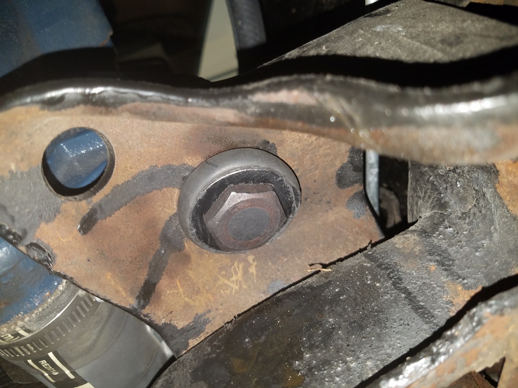

Attached is a pic of the passenger side bottom mount bushing. The top bushing is so stiff that I can see little to no compression of it, only the bottom bushing seems to be compressed and to my inexperienced eye (on this issue anyway) it seems excessively so, but perhaps this is normal for the repop mounts - ? The original top and bottom bushings, which had 37K miles on them, were equally compressed, relatively speaking. Given the clutch is so smooth and the engine vibration appears to be improving perhaps this is correct. Note again the bottom and top bushings have been confirmed to be seated correctly, all parts are installed in the correct orientation, and the castle nut was only tightened to the absolute minimum tightness to insert the cotter pin at the corresponding first 'castle'.
Thanks kubes40 to your reply on the other thread. If long-term, acceptable engine vibration improvement is not realized on this set I'll give Drake's a go. Carpenter is so close and given these are replacements to correct the erroneously provided first set it was necessary to go with theirs for this iteration. Their top bushing seems extraordinarily stiff compared to the bottom.
Comments on the bottom bushing 'bulge' appreciated.

len47merc
02-26-2017 @ 7:59 AM
Posts: 1168
Joined: Oct 2013
Man I do this a lot - attached is the pic.
Steve
02-26-2017 @ 8:17 AM
Posts: 3575
The bolts that come with the repop mounts are shorter than the authentic. That may be why it seems you have to compress the rubber so much. Drake, in my opinion, makes the best quality mounts. However, his bolts are also too short. My .02¢? Use his rubber mounts and the authentic bolts.
