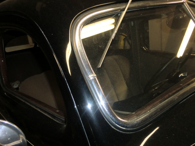

Hello,
My 37 Sedan Delivery windshield frame is comprised of a left hand and right hand side (picture is attached). All the Ford books I have indicate it is comprised of an upper piece (78-701220-A) and lower piece (78-701230-A).
I believe mine to be the original windshield frame, but could be wrong. It does fit the window opening perfectly. What am I missing?
Thanks for help solving this mystery.
Gregg

02-16-2017 @ 3:58 PM
Posts: 1301
Lets see a picture of the front side....

I've never seen a 37 windshield frame with those "T" brackets on the inside of the frame. looks to me like a repo frame or something made up by a prior owner.

Attached is a front side pic, it is painted body color per "Standard" model.
I agree the center T pieces are incorrect. Close up it looks like they are home made pieces. I don't know what the correct center section is supposed to look like. Any pics would help. I bought this car back in the 60's, maybe there were repro frames back then? It is pretty weird since the frame itself looks to be well made and perfect fit.

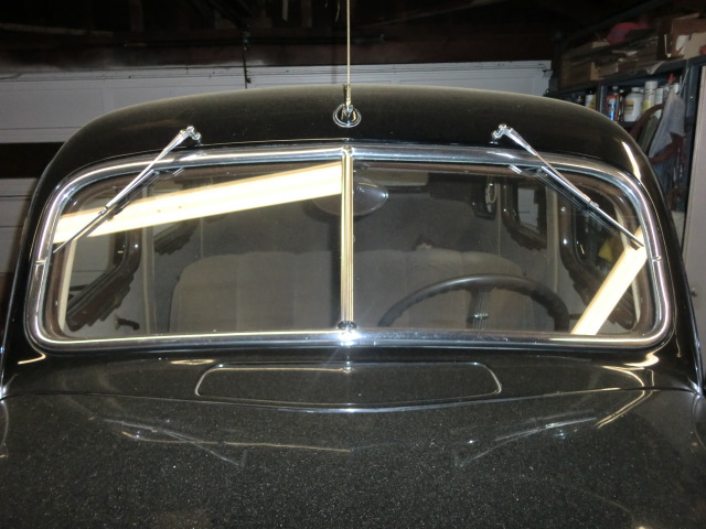

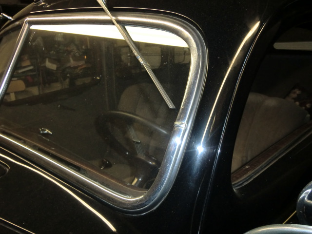

The windshield frame on my '37 Fordor Sedan is different in that it looks like it goes together top to bottom. There are two chrome splice covers (terminology) on the center of each left & right vertical end frame.
Pictures attached Below
MG
02-16-2017 @ 6:25 PM
Posts: 1301
Another....
MG
02-16-2017 @ 6:26 PM
Posts: 1301
Another....

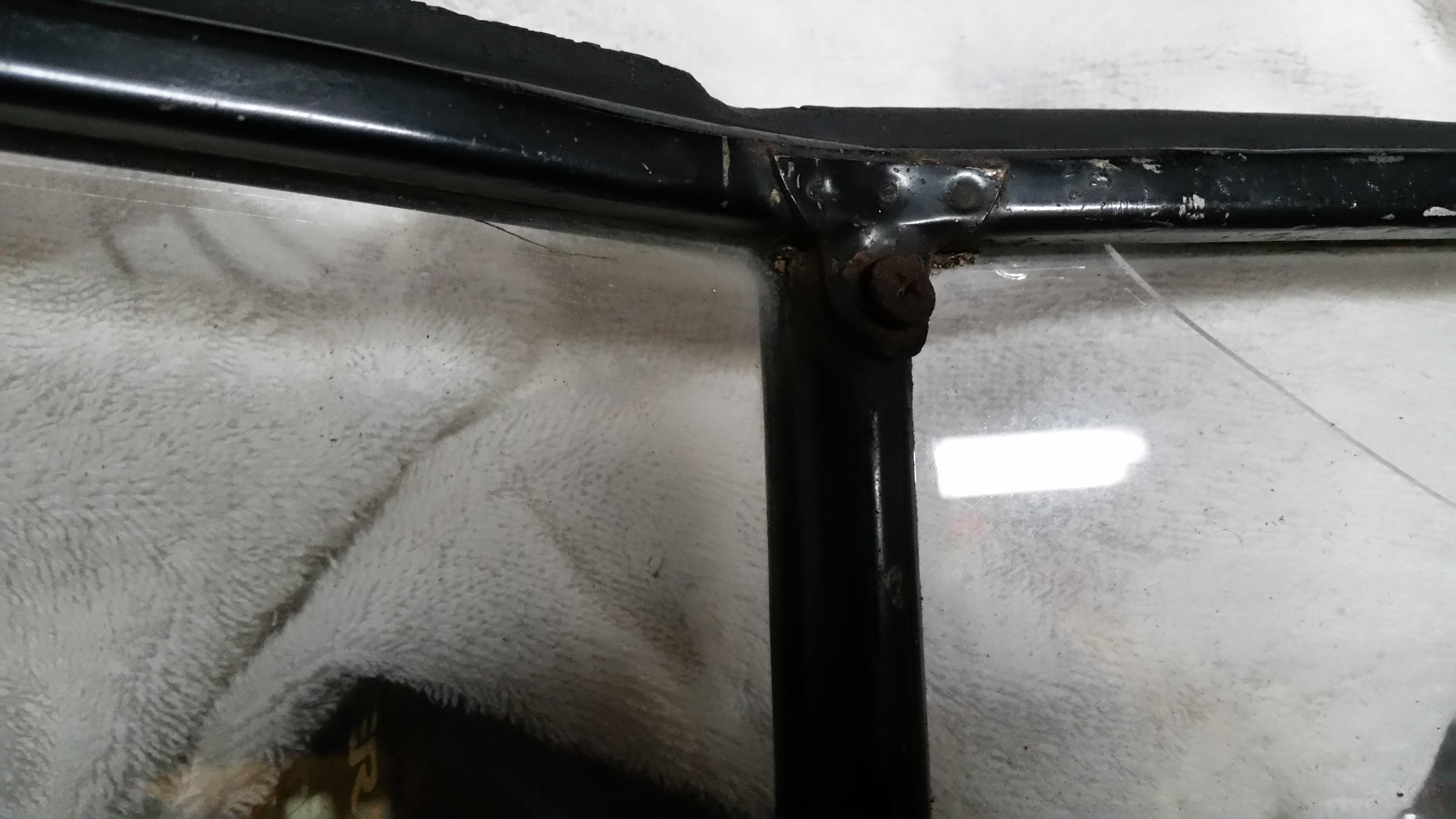

I have an original '37 windshield frame, it came out of a '37 that I restored in the mid 1960's. It is chrome on the outside, painted on the inner side. The center bar is flat on the outside to match the frame, the inside of the division bar is half-round. There is a very small T clip, approx 3/4" long at the top which is spot welded to the face of the upper frame, attaches to the division bar with a very small screw. The frame still has glass in it.
I can take some pix of the frame, however, I'll have to take it down from the wall it's attached to.
I would surmise that someone repaired the frame many years ago, the T bars are not very well made.
