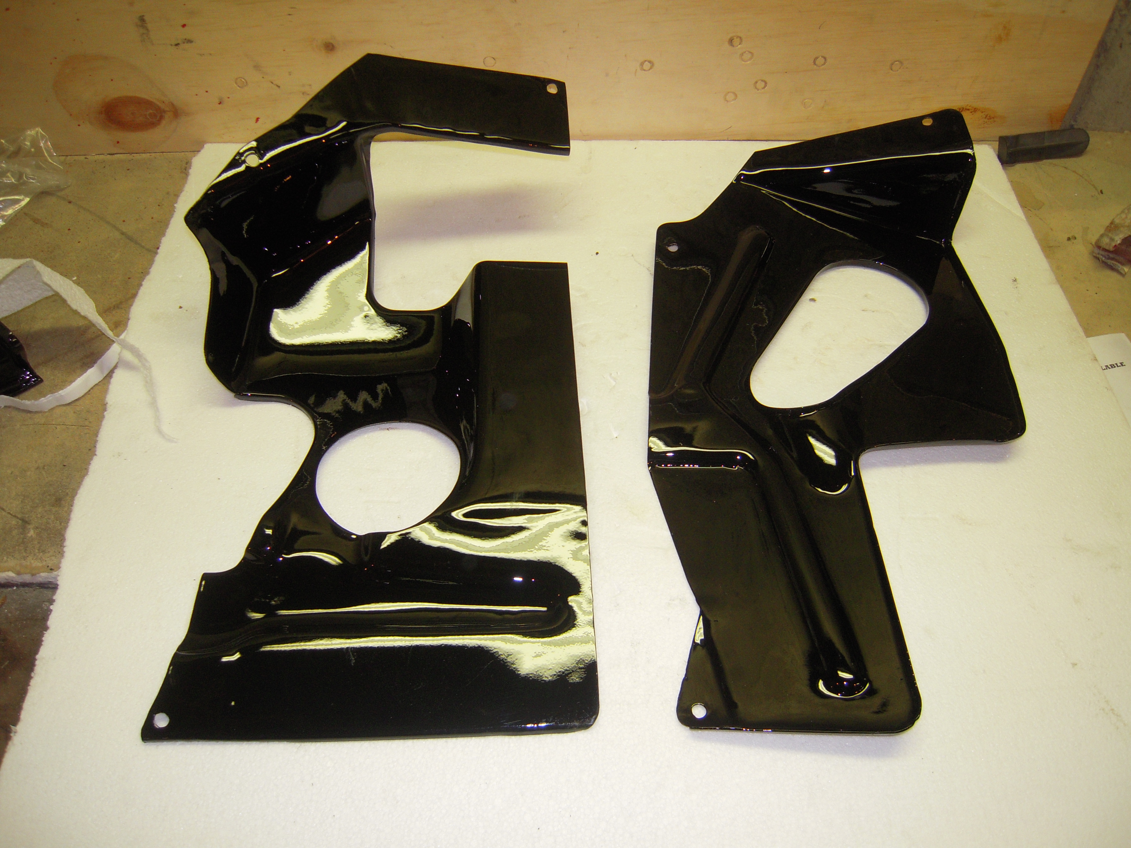

Jay, The pans are almost always gone. They were a bit of a project to remove properly and most times, mechanics would simply cut them to remove and unfortunately not replace them.
They are not rare and as has been previously advised, are often offered on eBay. For a decent pair, expect to pay around $75 - $100.
And yes, they will help with the proper air flow. Somewhere around here I have an engineering drawing of the air flow with the pans in place.
The pair in the photo are 1939. They will fit perfectly and function the same as a set for 1940 but are not concourse correct for '40.
