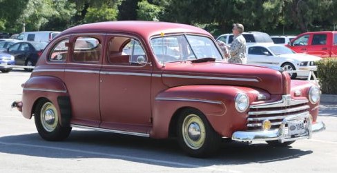

I'm putting Edelbrock aluminum heads on my wife's '46 sedan. I see different gaskets and don't know which to use.
I was looking at FELPRO, but there are 2 different part numbers and I don't know which I should choose.
7283 B
7548 B
Your input is requested. Thanks
