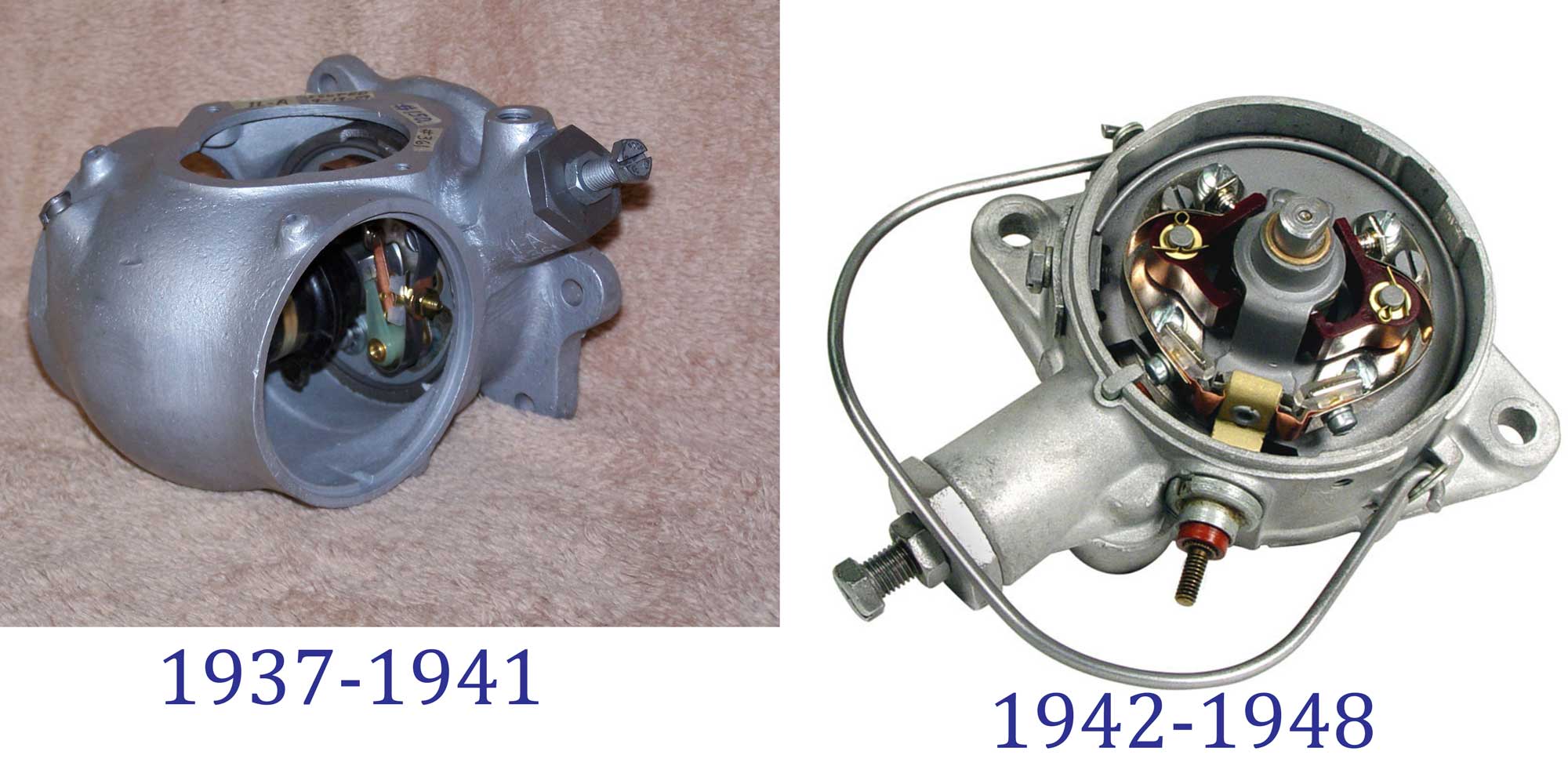

Ken Check
12-12-2016 @ 8:18 AM
Posts: 7386
First I would like to know if you have the early helmet type distributor or the postwar pancake distributor. Next I would like to know if you are using a period correct coil for the distributor or the later 1949-1955 round coil.
In either case, you should connect a volt meter to the input of the coil and crank the engine while watching the meter. It should change from about 6 volts to about 4 volts if you have an external resister. You will have less of a change if you have a coil with an internal resister.
Make sure that you coil leads are connected so that the + terminal goes to the distributor.
If you have the 1942-1948 distributor, check that the wires are making good connection in the cap and that the wire going from the coil to the distributor is not broken internal to the insulation, by giving it a good tug.
If you have the 37-41 distributor, you are probably using an adapter plate on top of the distributor. These can have problems with the connection to the points. You can check out this connection by checking point resistance. Connect the + or red lead to a good ground and the COM or black lead to the coil terminal going to the distributor. Put your meter on the ohms position and read the resistance. It should read open with the points open and 0 ohms with the points closed. With the points closed, wiggle the wires to check for a bad wire and loosen the mounting screws for the adapter plate evenly until the connection is open. You should be able to loosen them enough to free up the lock washer, before the connection shows open.

This is the clamsh*ll type distributor. The only visible thing is that the metal tabs inside the cap look to have small grooves in them where the rotor may have rubbed them at on time.
