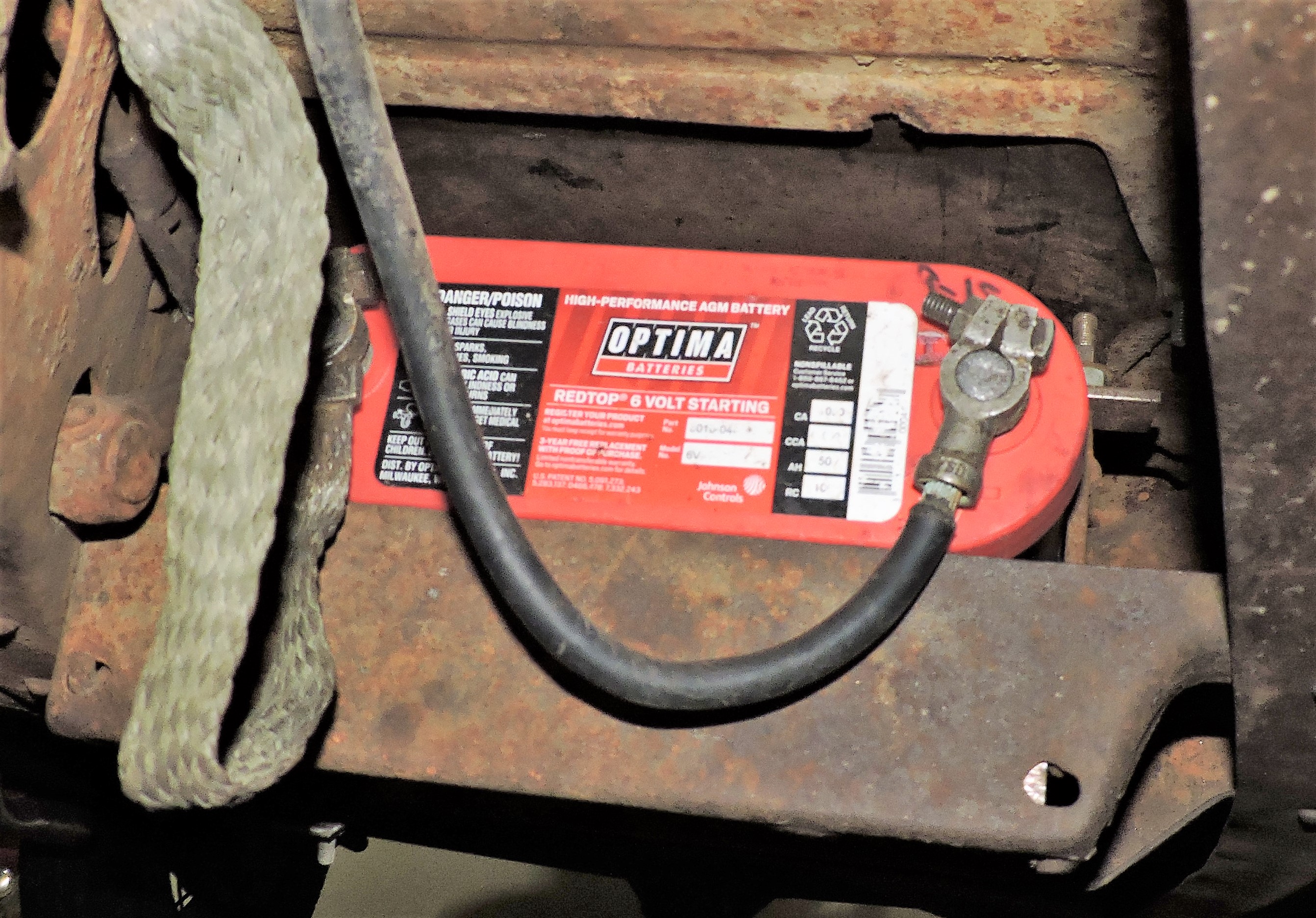

Sneezer |
12-18-2016 @ 7:54 AM
Posts: 63
Joined: Aug 2016
This is my solution for mounting the Optima battery. Easy disconnect from under the car. Easy to attach a charger to when needed
