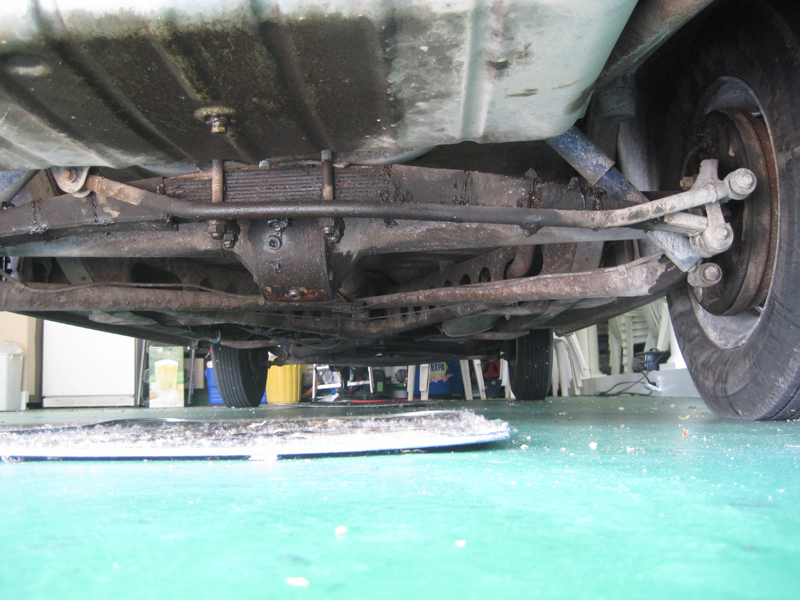

I have a 46 BC that Im restoring. Is there no panhard on this model? There is no hole for one in the spring crossmember. The rearend is moving 2-3 inches sideways so there must be something missing or am I missing something?

The BC designation is not familiar to me, could you post a photo of the car so we can see what model it is?
It is unusual for the rear end to move sideways with the transverse springs and lever shocks.

If you're talking about the tracking bar that keeps the car centered, you've got to have one or you get what you're getting. See picture.

One end of the track bar bolts to the right side wishbone. The other end blots to a bracket that is bolted to the lip of the crossmember on the left side.
