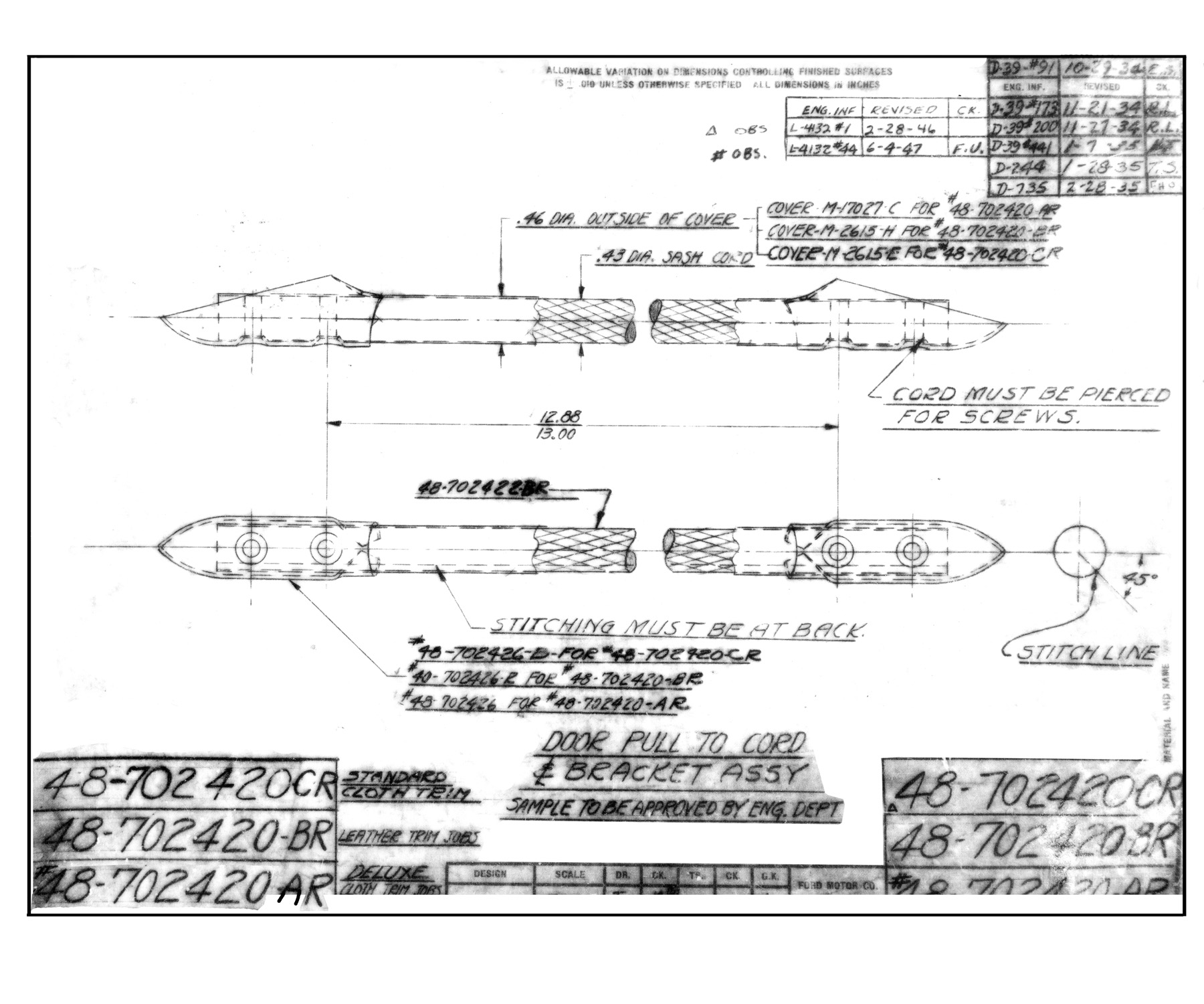

I need to know how long the rope door pull is from tip of the metal ends. Also, were they the color of the upholstery?
Don Rogers
11-02-2016 @ 1:23 PM
Posts: 512
Keith, Here is a copy of an Archive's drawing showing the door pull to cords for 1935 Ford passenger cars. The length is shown as well as material references. Hope this helps.

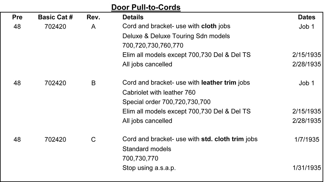

11-02-2016 @ 1:38 PM
Posts: 512
Keith, Here is a timeline for when the pull cords were used on 35 passenger cars.
keith oh
11-03-2016 @ 8:22 AM
Posts: 116
Joined: May 2010
Thank you Don, I will install as shown. I have had little trouble with the driver side handles breaking but passenger side has been broken a couple of times the past 50 years.
