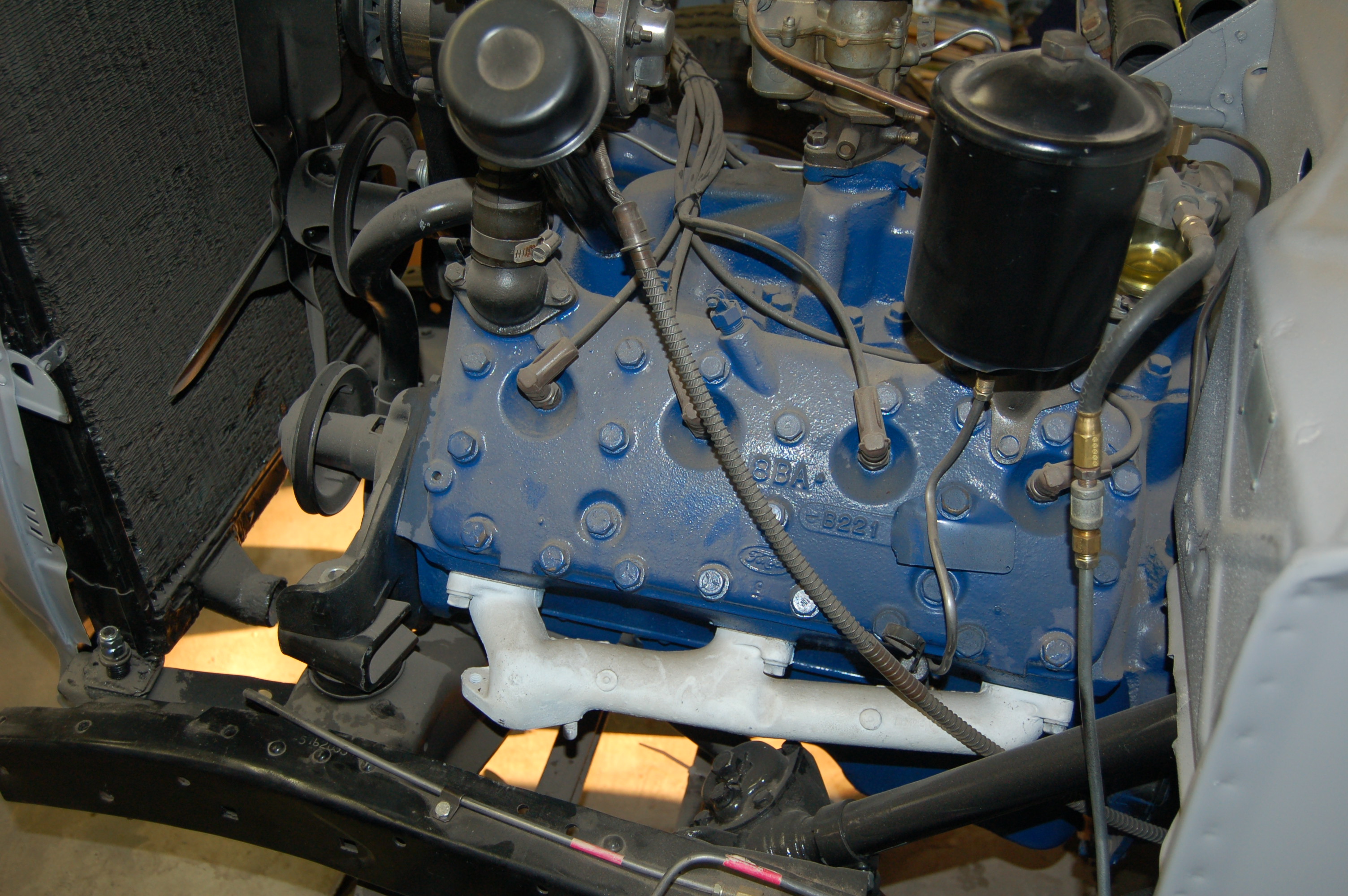

wmsteed |
10-30-2016 @ 10:15 AM
Posts: 613
I would have to assume that the '53 8CM engine being in a F-5 truck would have truck and/or '49-50 Merc water pumps with the '49-50 Merc frame mount spacers. See the attached pix of an 8BA engine in a '37 Ford truck. The bell housing/flywheel, clutch assembly that was used to put the 8CM into the F-5 will most likely not fit the '46, but then again it might. The engine will have to be pulled to establish just what was used, and what will be required to complete the re-assembly into the '46.
Bill 36 5 win delx cpe
