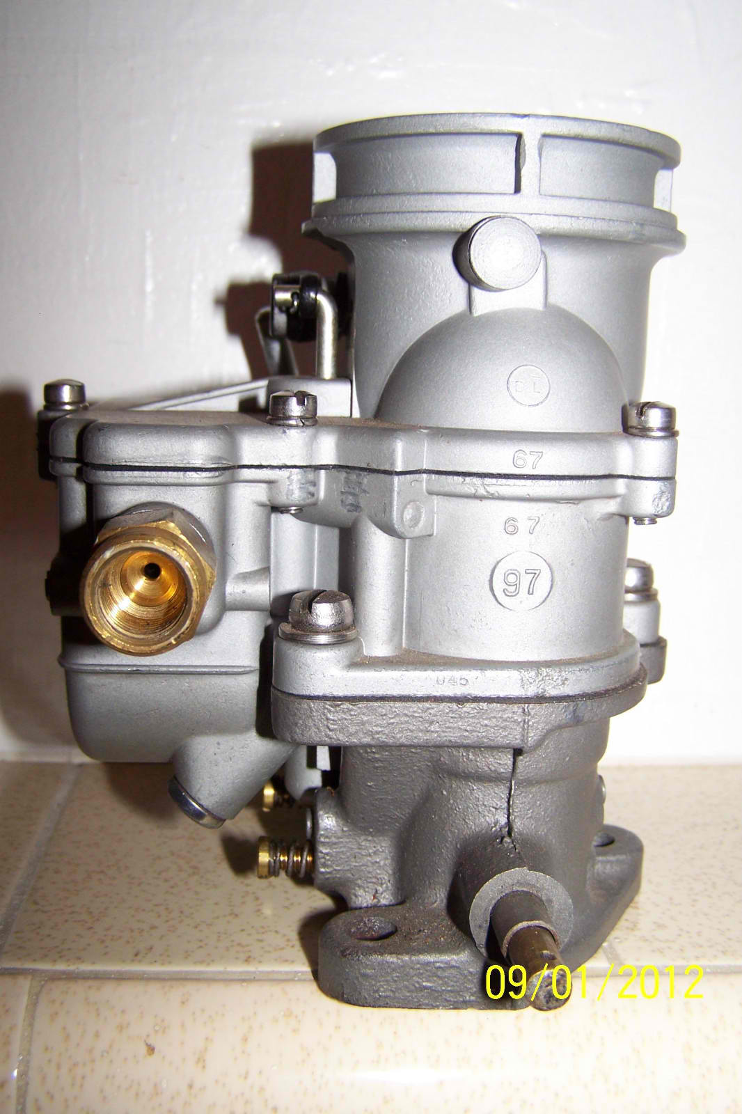

jwitt
10-28-2016 @ 12:45 PM
Posts: 28
Joined: Mar 2016
That's interesting information. The carb on my '36 has a (I think) large 97 on the carb body and a top with a 67 on it. Maybe a mix and match from a rebuild somewhere along the way, though the patina and finish on both parts match well.

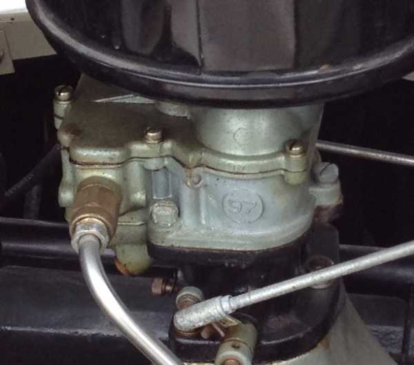

Bob56
10-28-2016 @ 12:55 PM
Posts: 129
Joined: Jun 2012
this is exactly what I have. 67 on top and 97 on the bottom. I need to replace the fuel pump as mine has the glass bowl which is wrong

ken ct.
10-28-2016 @ 1:26 PM
Posts: 1513
Its a mix and match,the top was replaced in the past, it will work but not correct. OMO ken ct.
