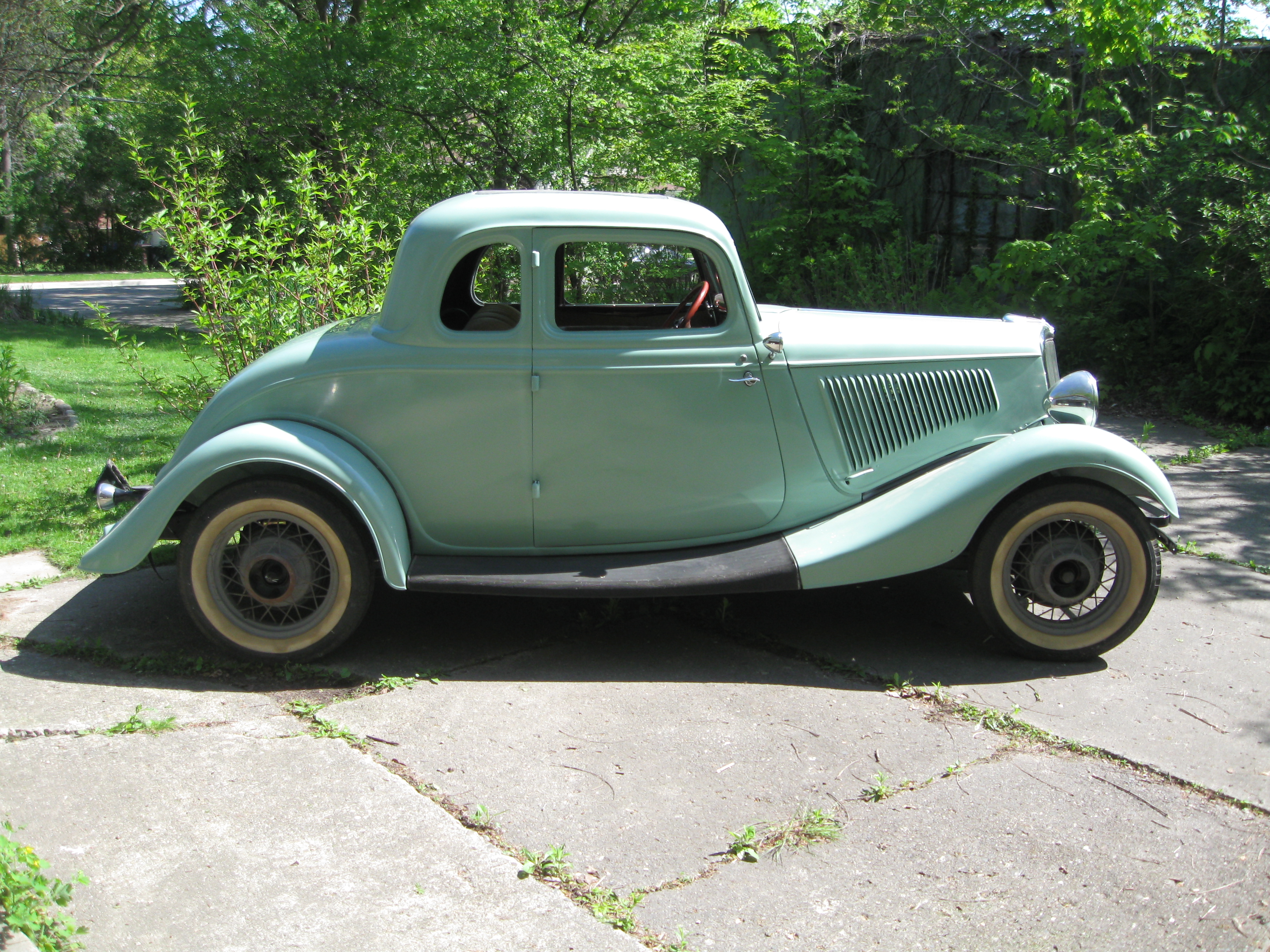

40cpe...got it, I'll do it. Thanks! Photo of the grateful coupe from a few months ago
