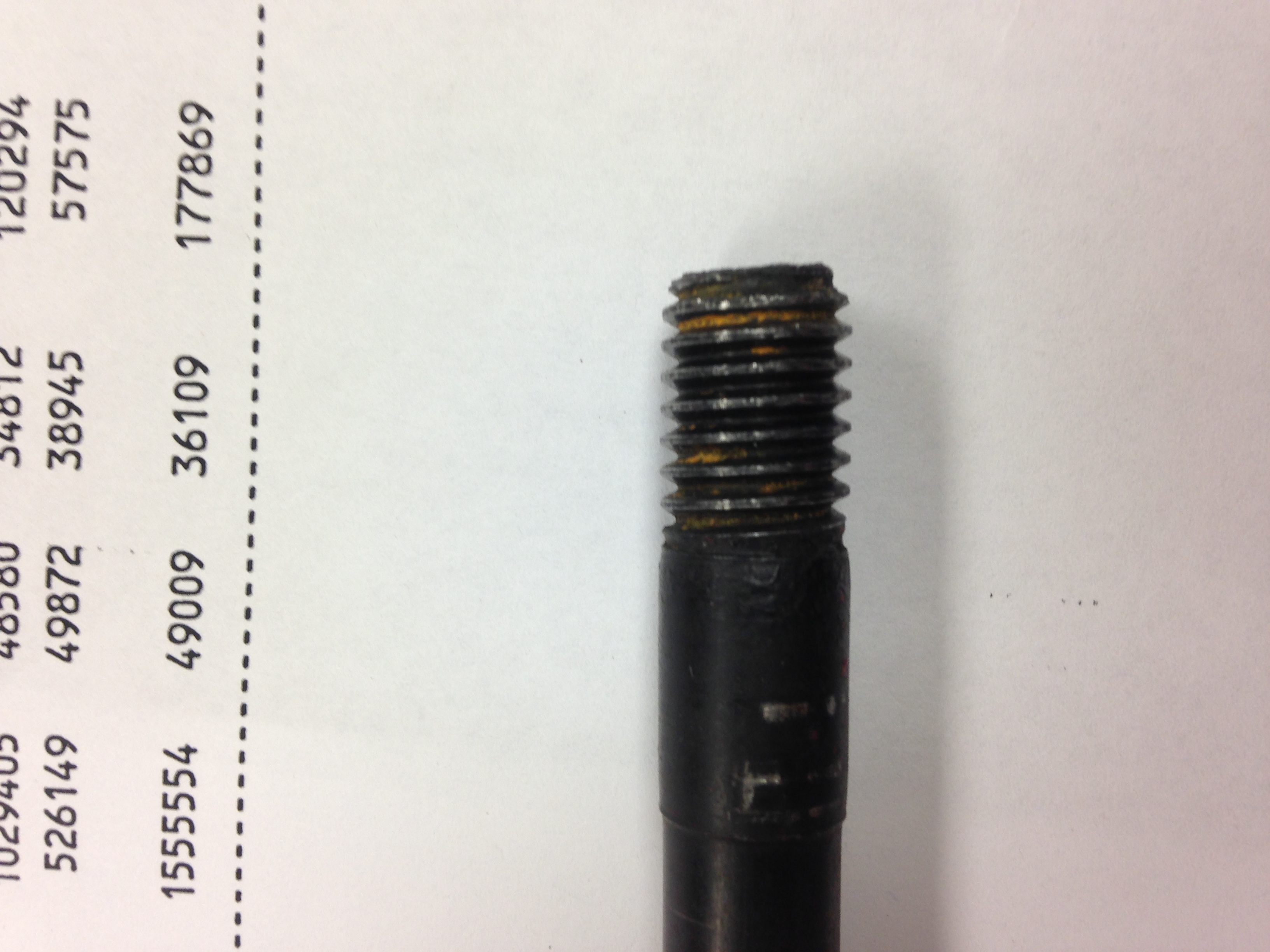

I'm starting to wonder if it might have broke off as the end of the stud doesn't look machined.
3 5/8' long here's a pic.
By the way assuming this stud should be replaced who's the preferred vendor?
cliftford
10-03-2016 @ 11:47 AM
Posts: 845
Joined: Jan 2014
Van Pelt, C&G or maybe your local NAPA or other parts store would have them.
