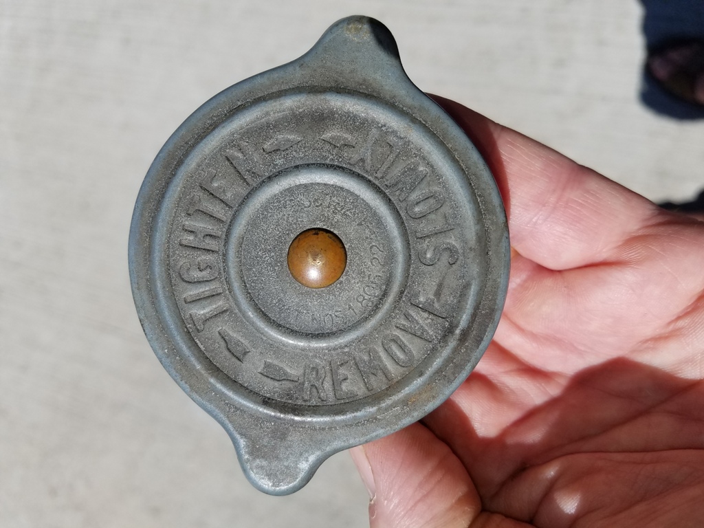

Here's the top of the cap that came with the car and is thought to be the original.
Steve

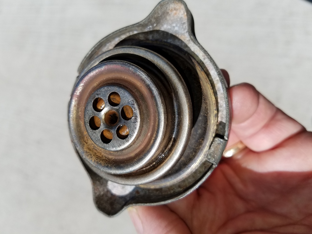

And a pic of the bottom of the cap.
Steve

I don't have an answer for the 20 degree change, but I would question if the conditions are exactly the same, (same temp, same wind, same sun,etc). The cap that you call the original looks like a pressure cap to me, are you sure that it doesn't provide pressure? Are you sure that your aftermarket radiator cap is providing pressure?
