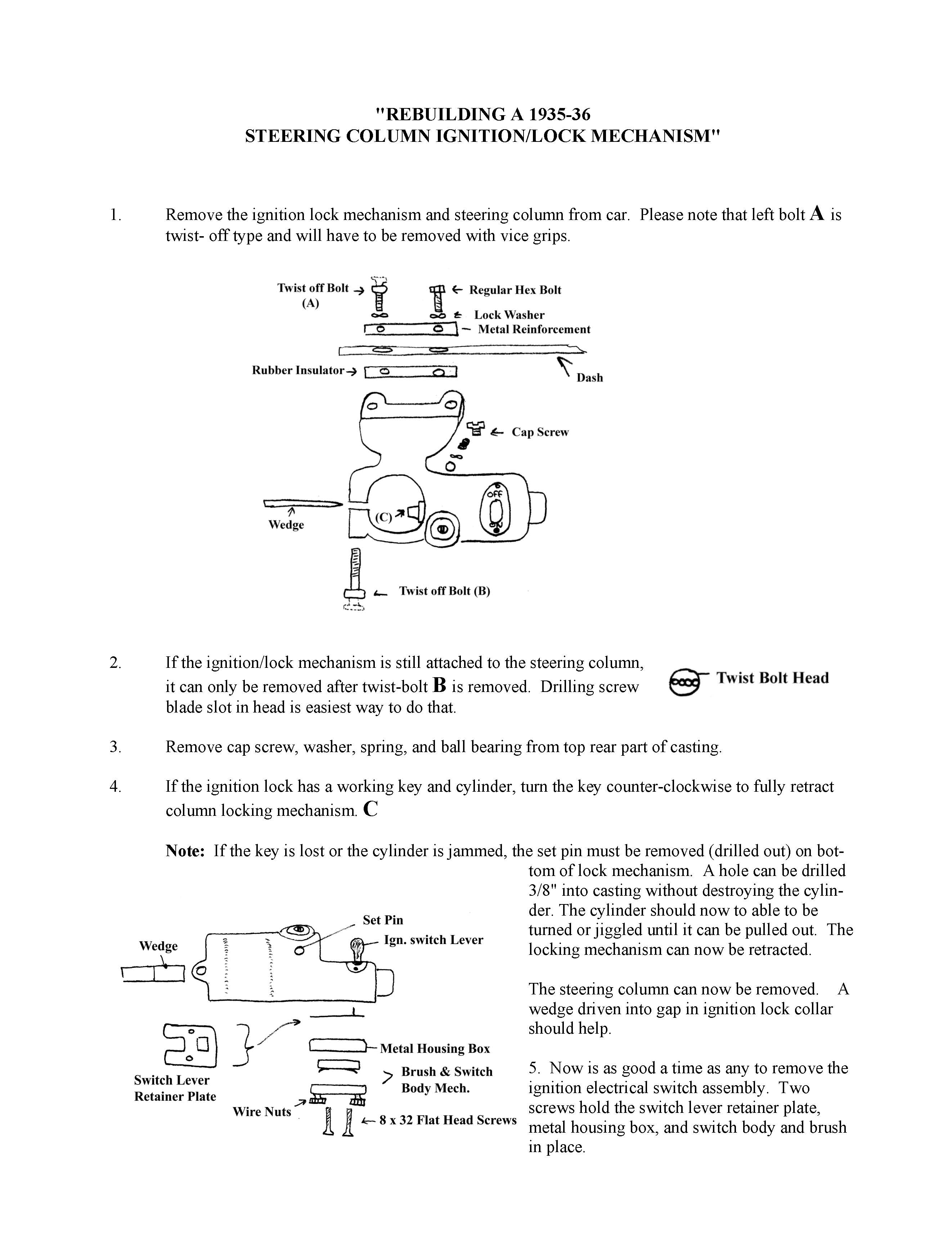

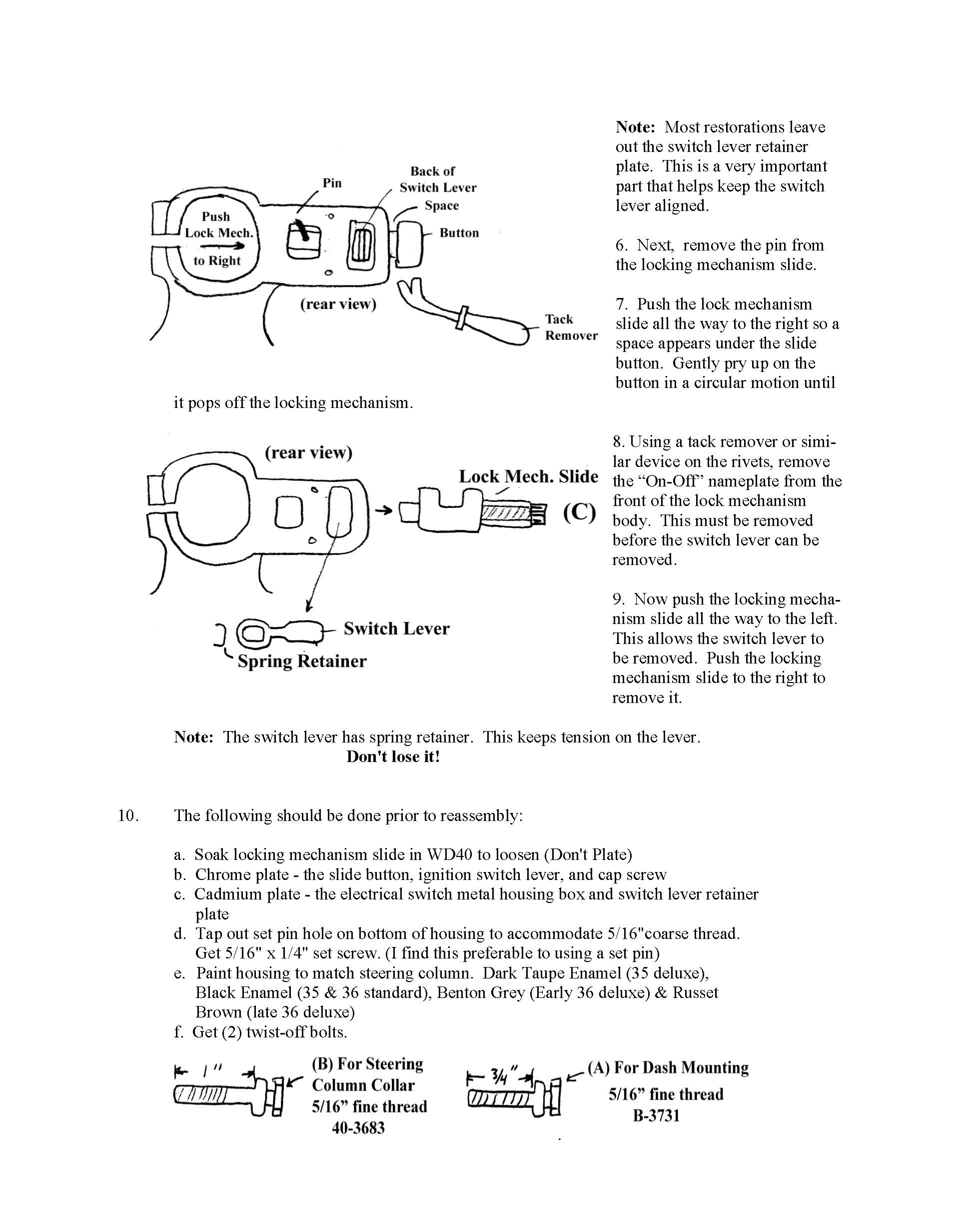

Larry, Here are some notes that I made a while ago that should help. I am also including an exploded view of an assembly drawn by Gary Tossel a while back.
This message was edited by Don Rogers on 8-28-16 @ 8:21 PM

page 2

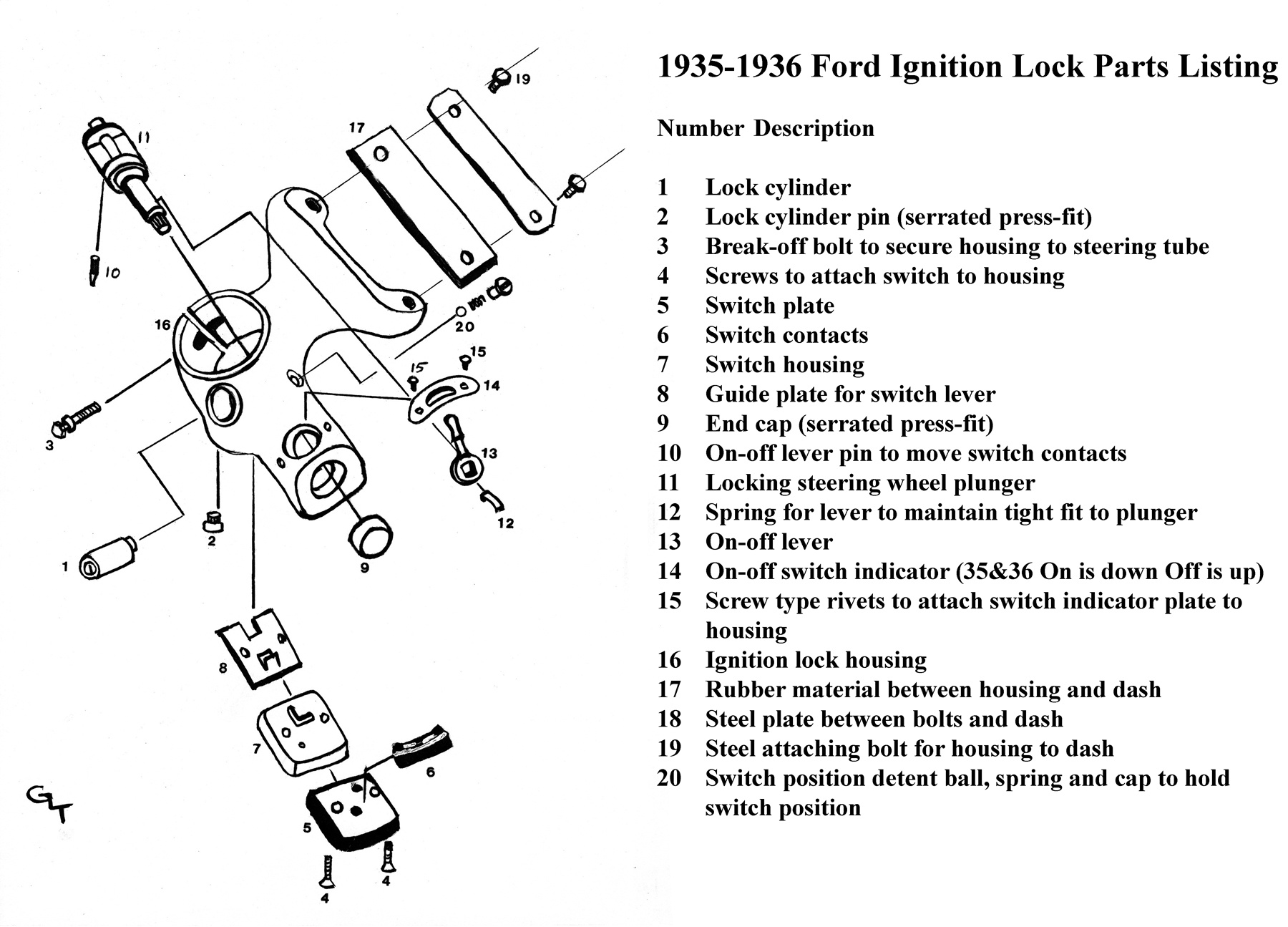

Here's Gary's exploded view

In Gary's exploded view (above) are you looking for part #8? If so, you will have to make it since there does not seem to be any reproductions and I have not found a source of originals. There are no special washers that I am aware of. The ignition switch is held to the rear of the column drop with just two #8-32 countersink head screws (parts #4 in the details above).

2 articles from the V8 times might be helpful vol. 39 [2002], issue 5, pg 15-16: removing the steering lock ass'y vol. 40 [2003], issue 1, pg 7-8: follow-up comments sounds to me like someone put lock washers in place of the small flat spring [part no. 12]
