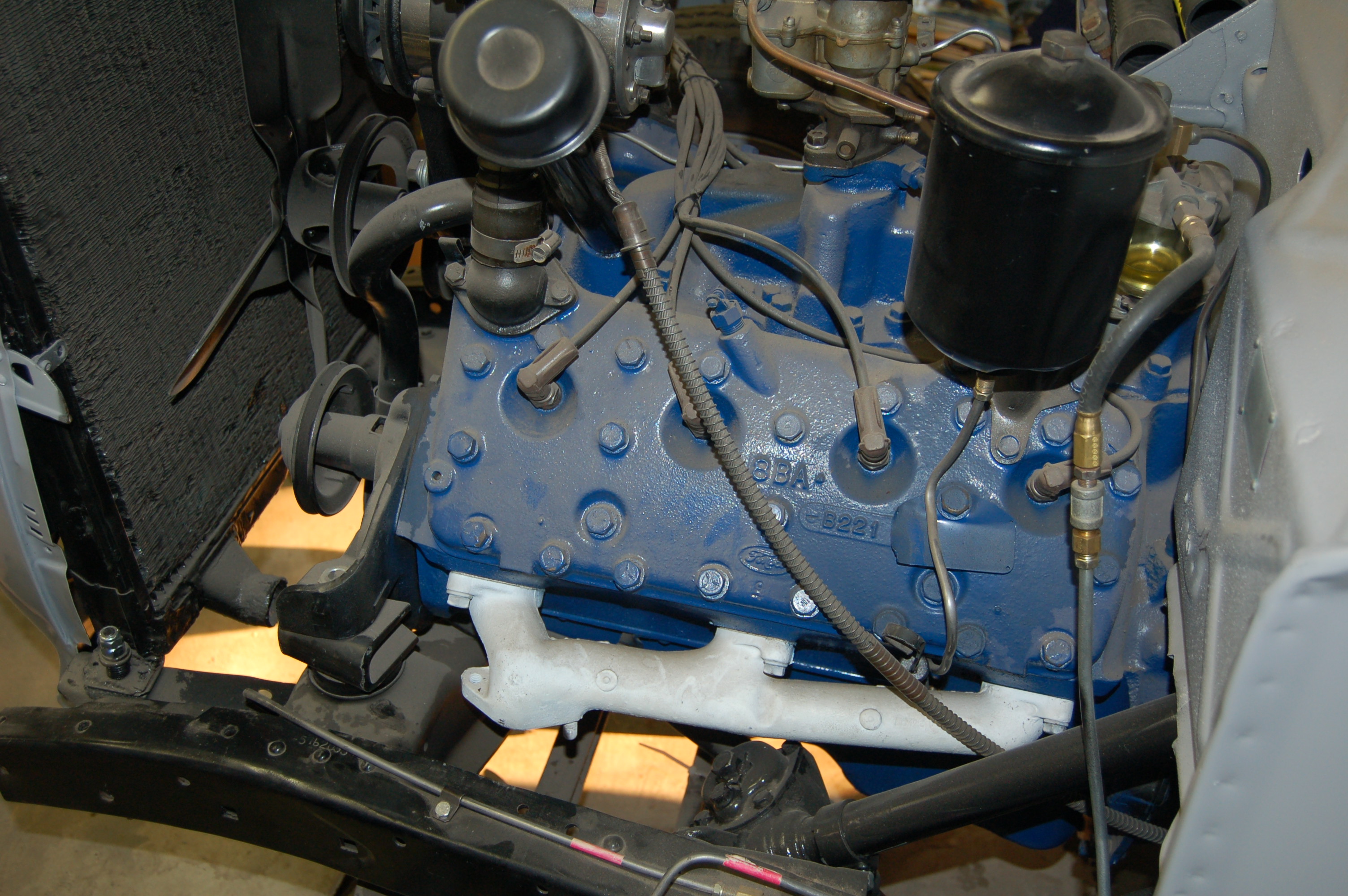

A friend of mine has an 8BA engine in his '37 pickup. I have personally installed two 8BA engines into '37 and earlier Fords. If the right combination of Ford/Merc parts are used it is a very simple swap.
I have attached a couple of pix of the 8BA engine in my friends pickup.
I prefer the stock '37 exhaust manifolds in lieu of the later model type that my friend used..
