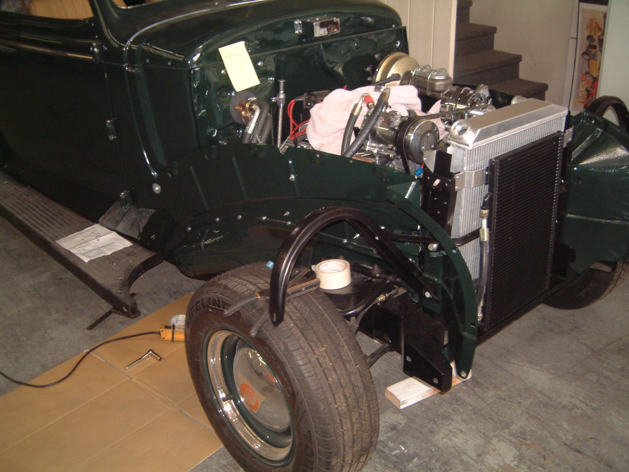

I have used aluminum radiators with great success in several of my recent vehicle restorations.
While talking to a good friend that builds vintage race/performance cars, he told me about performance radiators that Summit sells for performance cars. They are intended for cross flow applications, however, the radiator does not know if it is standing up or laying cross-wise.
I have used these radiators in my '39 Plymouth, '37 GMC, '49 Olds 88 and a '65 Chevy pickup..
The only tricky part is getting a radiator that will fit the application, then ordering a radiator for a Ford for a GM application, and a GM type for a Ford application. The cross brand application puts the in/out tube in the proper position for the vehicle being worked on.
