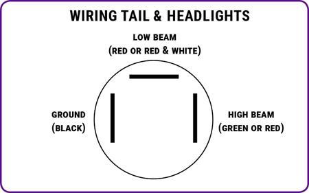

how were the Head lights grounded? I have a dim seal beam on one side and someone suggested it is a ground.

Some info from Mr. Google:
On a standard 3-prong/3-stud dual-beam bulb (such as an H4 / 9003 type), looking directly at the backside of the bulb (where the metal pins stick out), the terminal layout follows a standard triangle or "U" configuration: [1]
• Low Beam: The bottom (horizontal) tab/stud.
• High Beam: The left-side (vertical) tab/stud.
• Ground (-): The right-side (vertical) tab/stud.
Common Headlight Grounding Problems
• Paint and Rust Resistance: The headlight buckets bolt to the front fenders or core support, which rely on bare metal contact. Layers of rust, paint, or grease block current flow.
• Corroded Sockets: The internal socket and wire harness connections degrade over decades, leading to dim, flickering, or completely dead headlights. [1, 2]
• Missing Frame Straps: Relying purely on sheet metal paths causes high resistance.
• A 1950 Ford F-1 headlight grounding issue is usually caused by poor metal-to-metal contact on the painted fender assemblies, rusted headlight buckets, or a missing dedicated ground wire returning to the chassis or battery.
