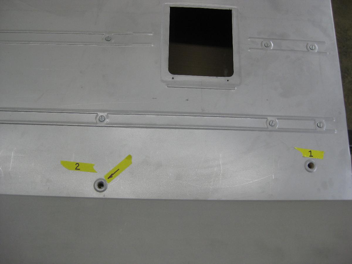

The bed floor MacHils sells through them looks just like the one I made. When I called MacHils at the end of Feb. it must have been the absolute worst day. What does the little cover for the gauge sender look like and how does it connect?

It is shaped like a square with one edge stepped down to fit under the edge of the bed floor. The other side fits over the bed floor and is scr*w*d into the bed.
I have attached a picture of the opening (a Mack Hils reproduction bed) showing the bed floor opening. I must not have taken a photo of the cover.

Made me chuckle! My old one has three pair of screw holes with one screw still stuck in on the rear of the bed. So the cover fills the recessed frame and the round corners, the holes there take sheet metal screws. Then on the far narrow edge it goes under and leaves the narrow margin exposed?

Yes, sheet metal screws hold the cover in place.
The one end slides under the bed opening and both sides are above the bed metal on the sides. The screws hold it in place.
