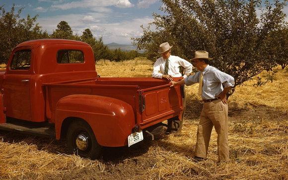

Hi you’re welcome! See 1948 promotional photo below for reference on tail light door color. Again stainless was available at dealer but they came painted black from the factory. I have a pair of NOS in the box black painted tail light doors. But I just had the stainless ones powder coated black. This way they won’t rust. If you mean the Rear Fender support bracket? Those bolts were cadmium plated which is a dull gray metal. I used the available stainless steel ones because of their location close the ground. You could just buff those up with a scotch brite pad to get a good approximation. The Don Bunn book has a lot of errors in it. Nice color pictures but not a researched product like the James Wagner book is. If buying parts for your truck I’d also recommend consulting with Chuck Mantiglia. Chucks Trucks . He’s the country’s foremost expert on Ford 1948-50 trucks. Advice is always free if you’re buying parts. He sells most everything you’d want.
