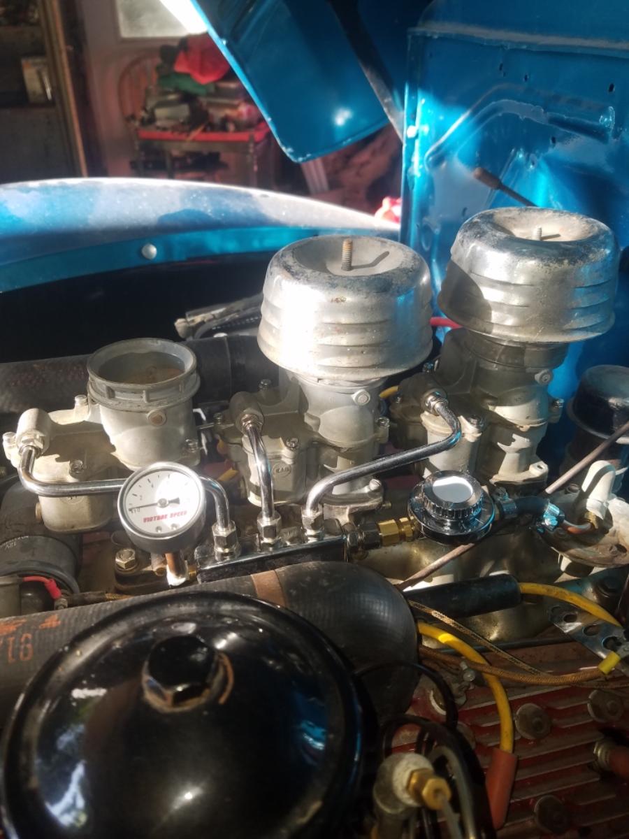

BE CAREFUL, the 94 carbs wont take fuel pressure above 2 psi. I recommend an inline pressure regulator and a 0 to 20 pound gauge. The electric pump you have will be at least 6 pounds. Found out the hard way. If you are interested, contact Charlies Speed shop in Florida. The extra carbs are just for show for now.
