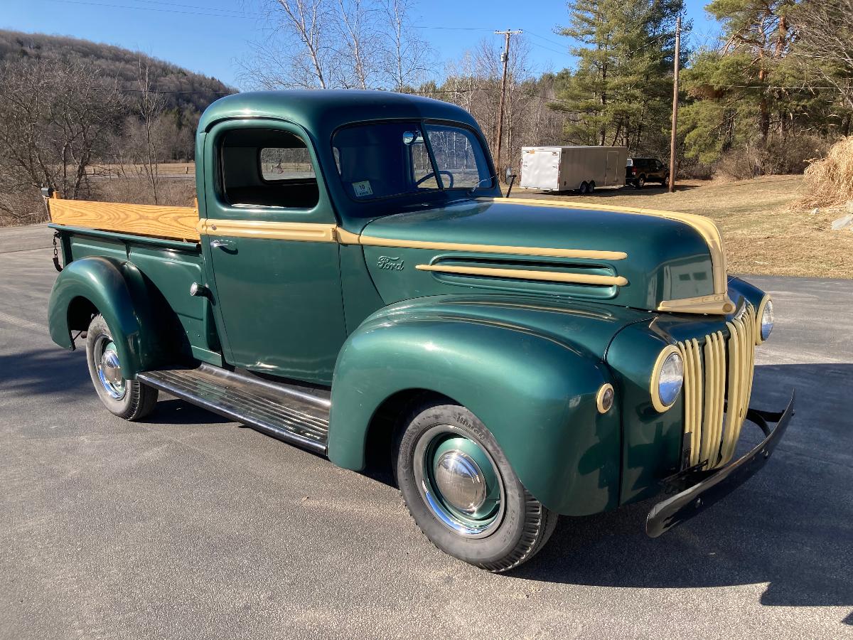

Hi Guys, I am a brand new owner of a 1945 1/2 ton, and new to this forum. Ford used 600 weight clinging gear oil because the seals would not seal with thinner oils. My truck seems to be a survivor, almost all original--so probably original seals. It's indicating about 48k miles, but who knows! The transmission is a non-syncro 4 speed. I'm leaning towards using the 600 weight, but wondering if modern synthetic gear oil makes the re-learning of double-clutching and driving a crash box easier, or just make it leak more? There are guys online saying they use modern thinner gear oil, but no comment as to what effect it has. Thanks, and if this has already been discussed repeatedly, I couldn't find it.

Man, what a great looking truck!
