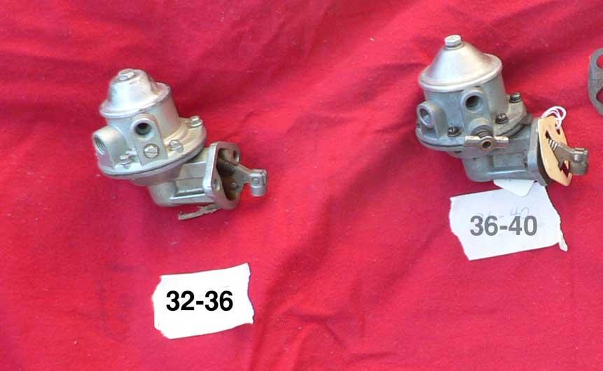

The fuel pump on my 36 221/85 hp quit. Can`t find an original anywhere on the internet only
with a glass bowl. Ordered a rebuild kit (which it called for) diaphram holes are spaced for a
larger pump- cork gasket to small with no help from the seller.Told me it is not original pump.
Who rebuilds fuel pumps? HELP

Highly recommend CharlieNY on the Ford Barn. You won't be disappointed and your pump will work like new.

x2 for Charlie. Great guy that does wonderful work at a very fair price. And, HE actually tests all of his rebuilds before sending them out.

Here is a photo showing the 2 fuel pumps that would be correct for a 1936 V-8. the smaller pump is for the early V-8 and the larger is for the later V-8. The label on the early pump is incorrect.
