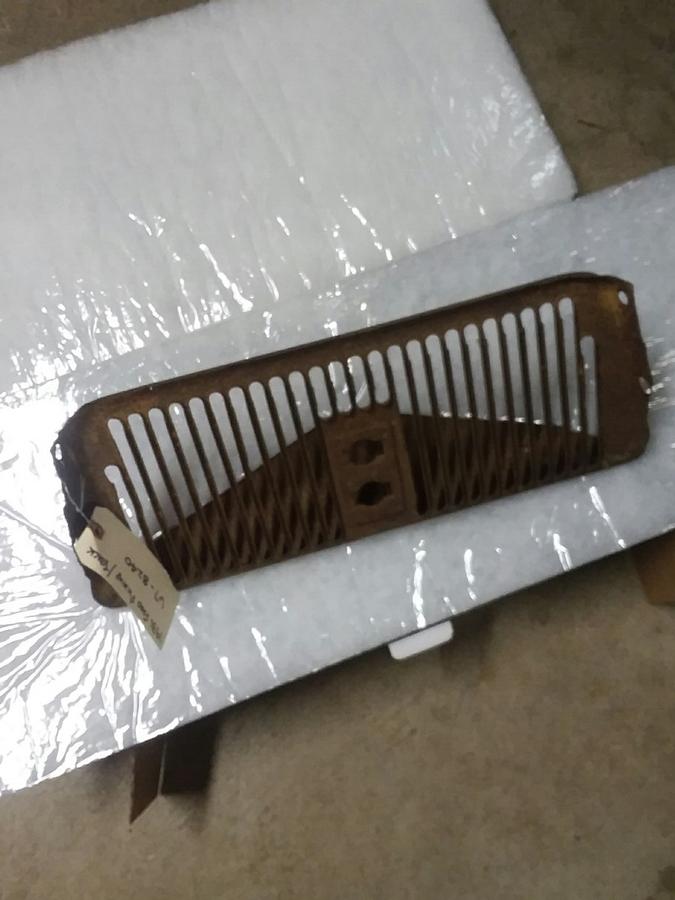

1) 1936 was a one only. 1935 grille was narrower and 1937 grille was shaped different at the bottom.
2) Two crank holes (one for 1/2 ton and one for big truck) and two large d-nuts along the sides
3) The picture you have attached is correct. (except missing the second crank hole)
4) Yes
