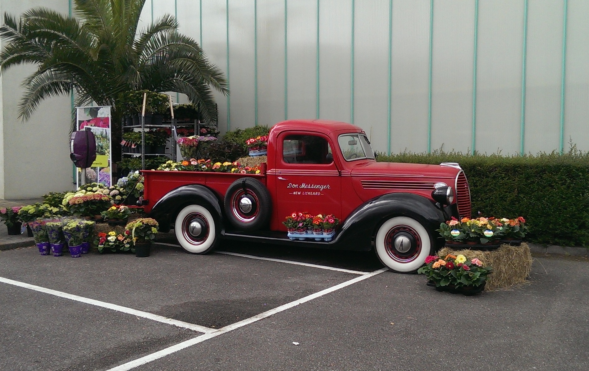

my name is Martin, living in the Netherlands and currently restoring our 1939 V8 Pick-up togheter with my dad.
it all looked quit solid, we own this truck for 6 years now. But now we're taking it apart it is worser then we thougt.
