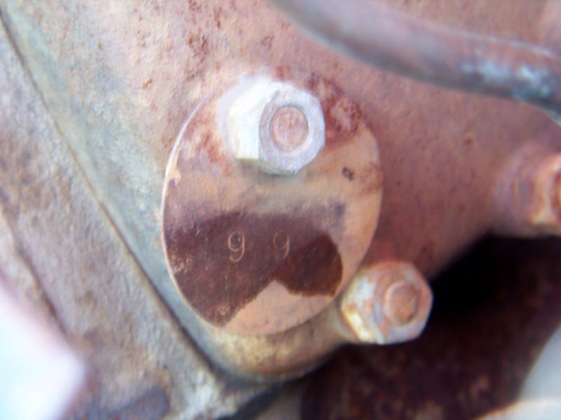

my 41 1 1/2 ton with the 100 hp motor has 9T heads and this tag. my 41 3/4 ton also had the 99 tag but had A heads-go figure that one out
