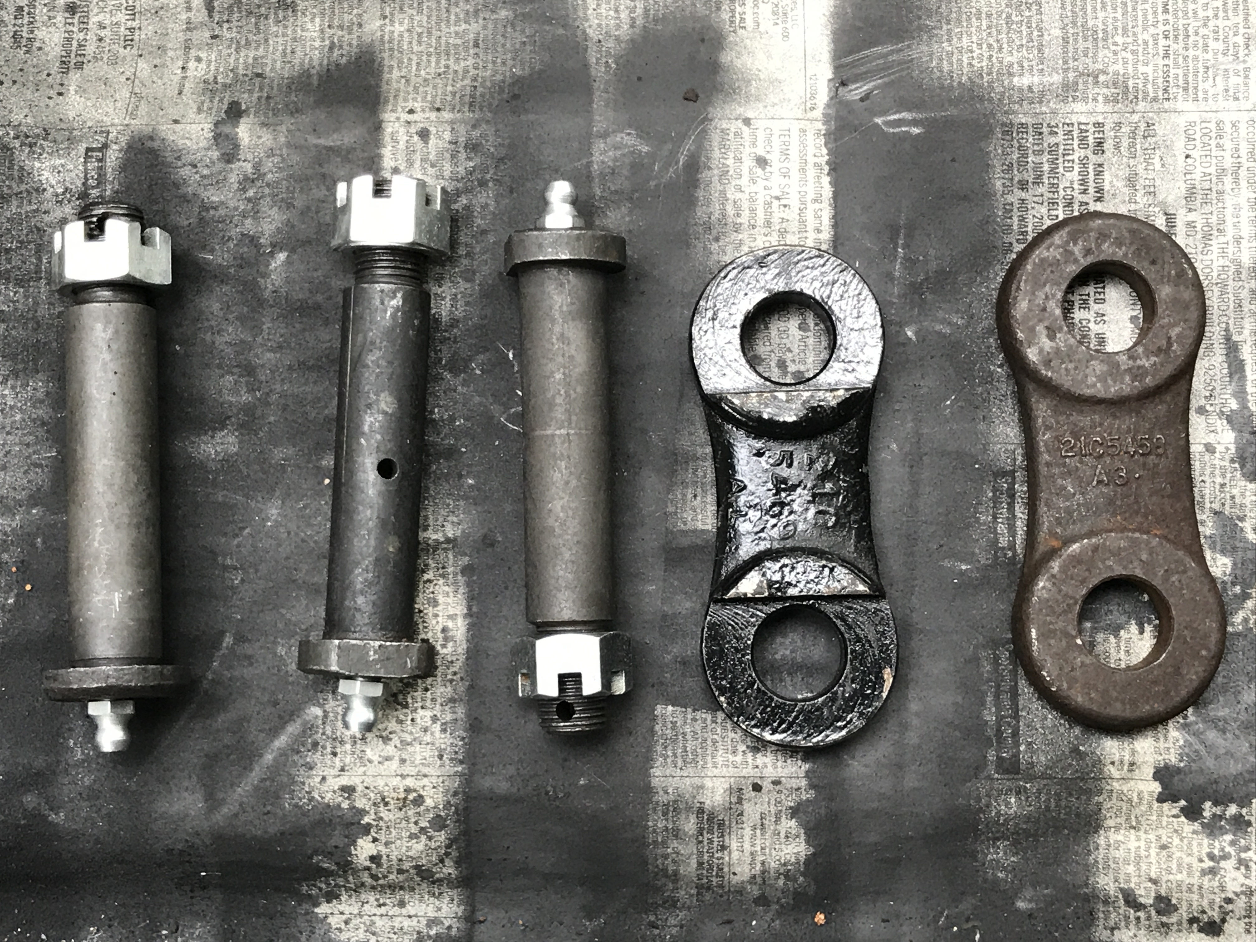

I bought the brackets for each side, they look a little like figure 8s, the bolts that go through the spring eye and the bushing associated with that bolt. The rears are the problem. Two bolts each side. NOS would be nice, but I have what I have and want to work on the truck this weekend. The truck is a nice restoration, but is not concours level. The shackles, front and rear, attach to the frame. The shock link goes from the shock to the axle mid spring. The springs are a more modern arrangement, parallel semi elliptical springs, than what is typical of Fords of that vintage. An interesting change for 1942, given that the cars kept the old arrangement up to 1948. Change was coming while Henry was still around. My truck has an open drive shaft, too. I am out of town. When I get back home, I will take some photos and attach them so you all can see what I am looking to replace.

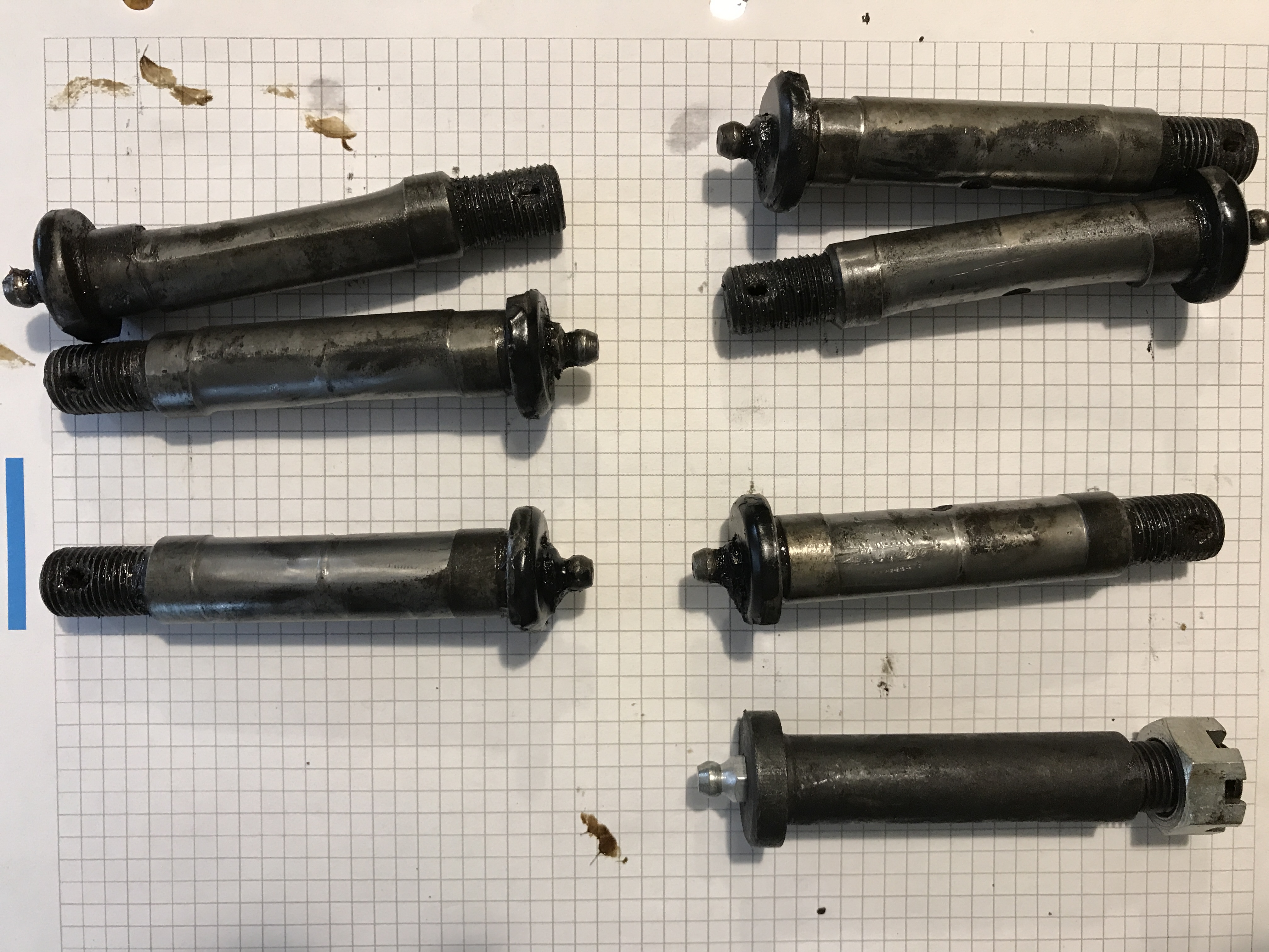

I got the springs removed and the shackles out. Not an awful job, taking about three hours. I jacked the truck up and put jack stands just aft of the spring hangers, letting the front end droop enough to take the load off of the springs. The bolts came out easily. I then removed the springs. The shackle bolts were very worn, as were at least two of the bushings. The hardest part was using a hack saw to cut the old upper bushings out. With a press, the bushings came out of the springs easily. One even fell out and required brass shim to get the new one to stay in. My next chore is to disassemble the springs and apply a graphite spray between the leaves. The shock links are giving me some trouble coming out. I have NOS ones ordered from Southside Obsolete. Hopefully they will arrive in the next couple of days. I am looking forward to getting the truck back on the road see how it drives with the new parts. It wasn't bad before, surprisingly.

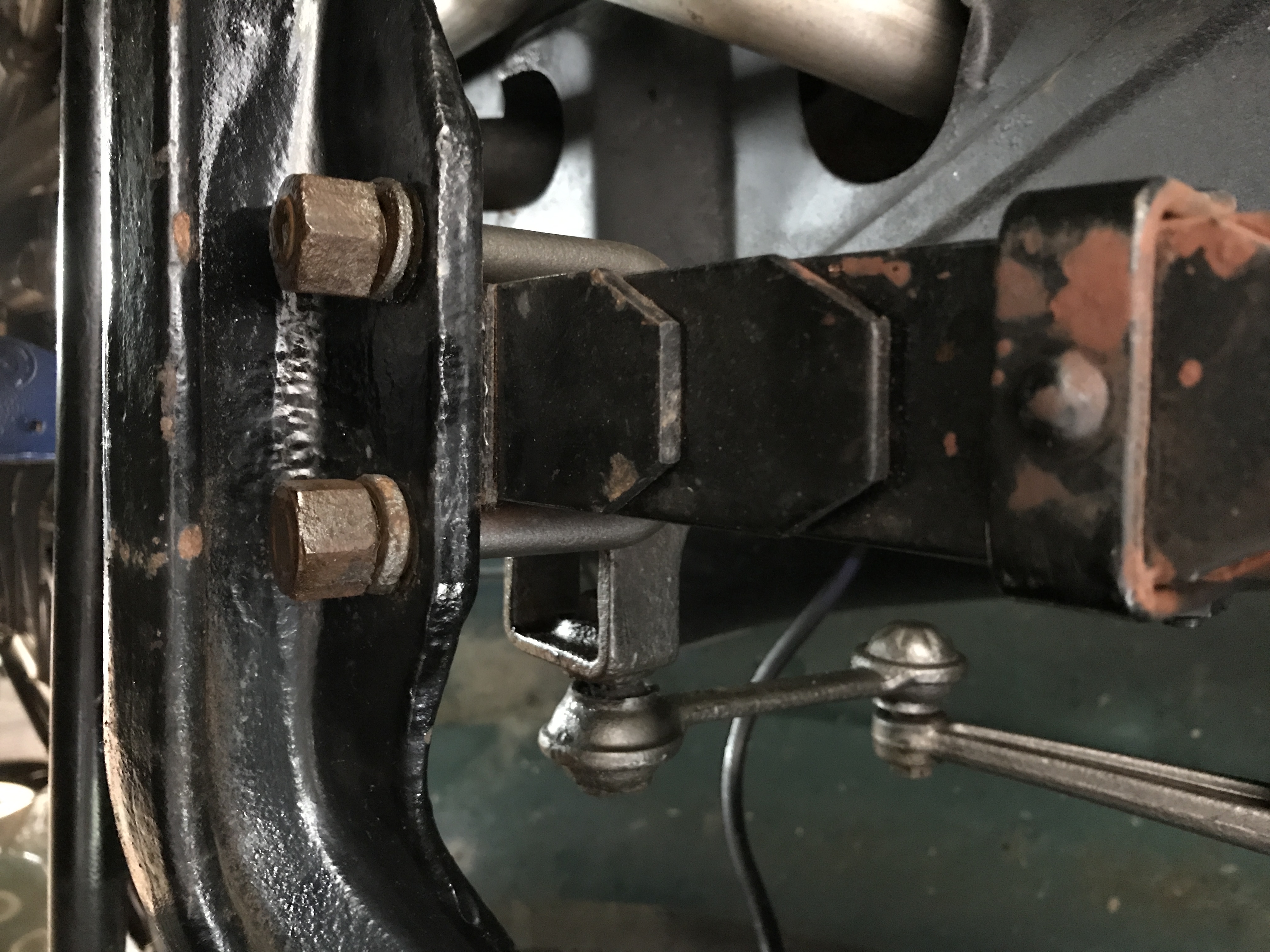

Here are some photos of the project.

I had to add the photos one at a time.
