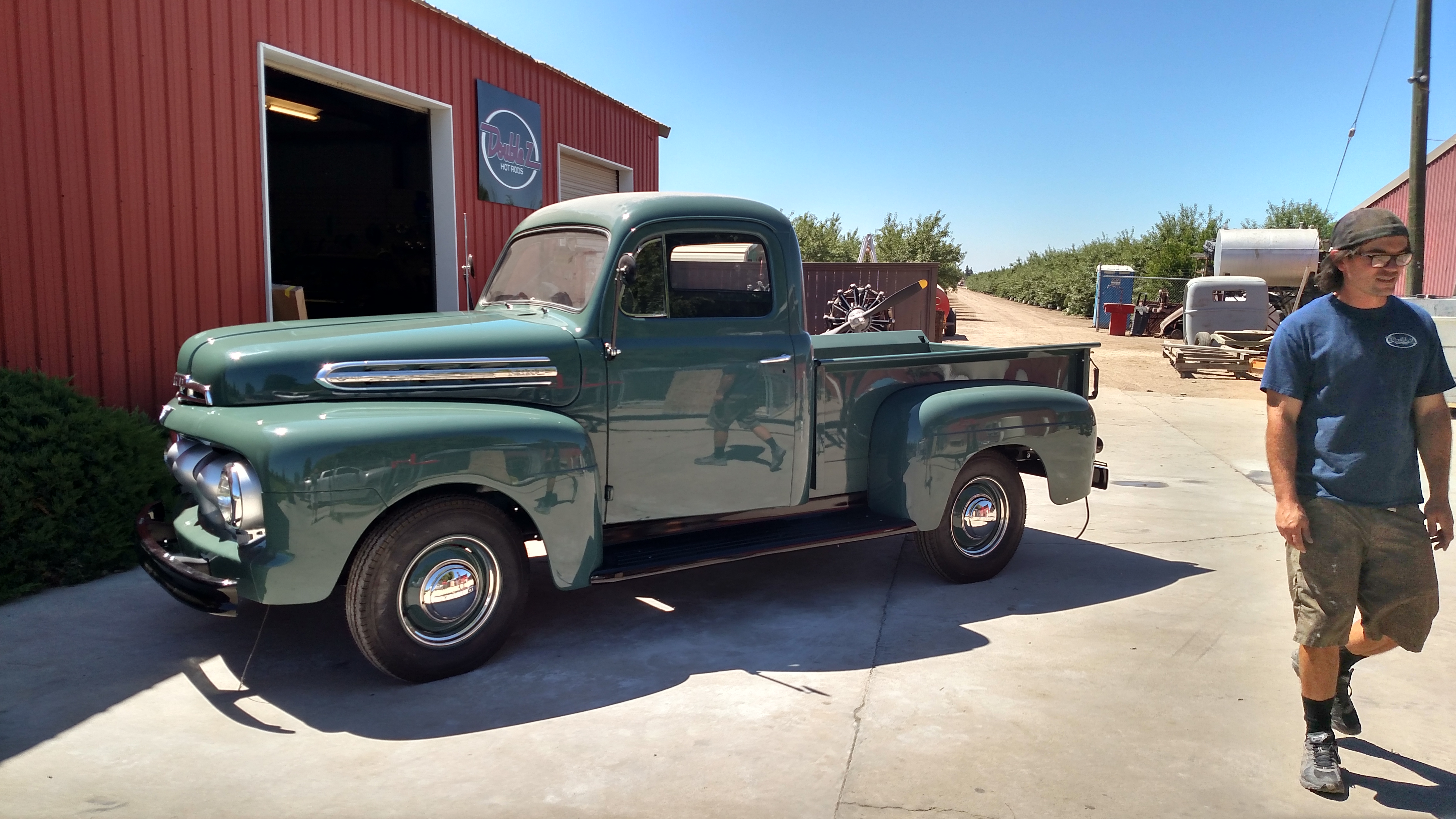

I am almost done with the restoration of my 1951 F1. I want to add seat belts (lap belts) to the truck. Can anyone recommend a vendor that sells belt kits that work well in this vehicle? I'm looking for something that looks like the aviation type with the pull up release. Thank you!

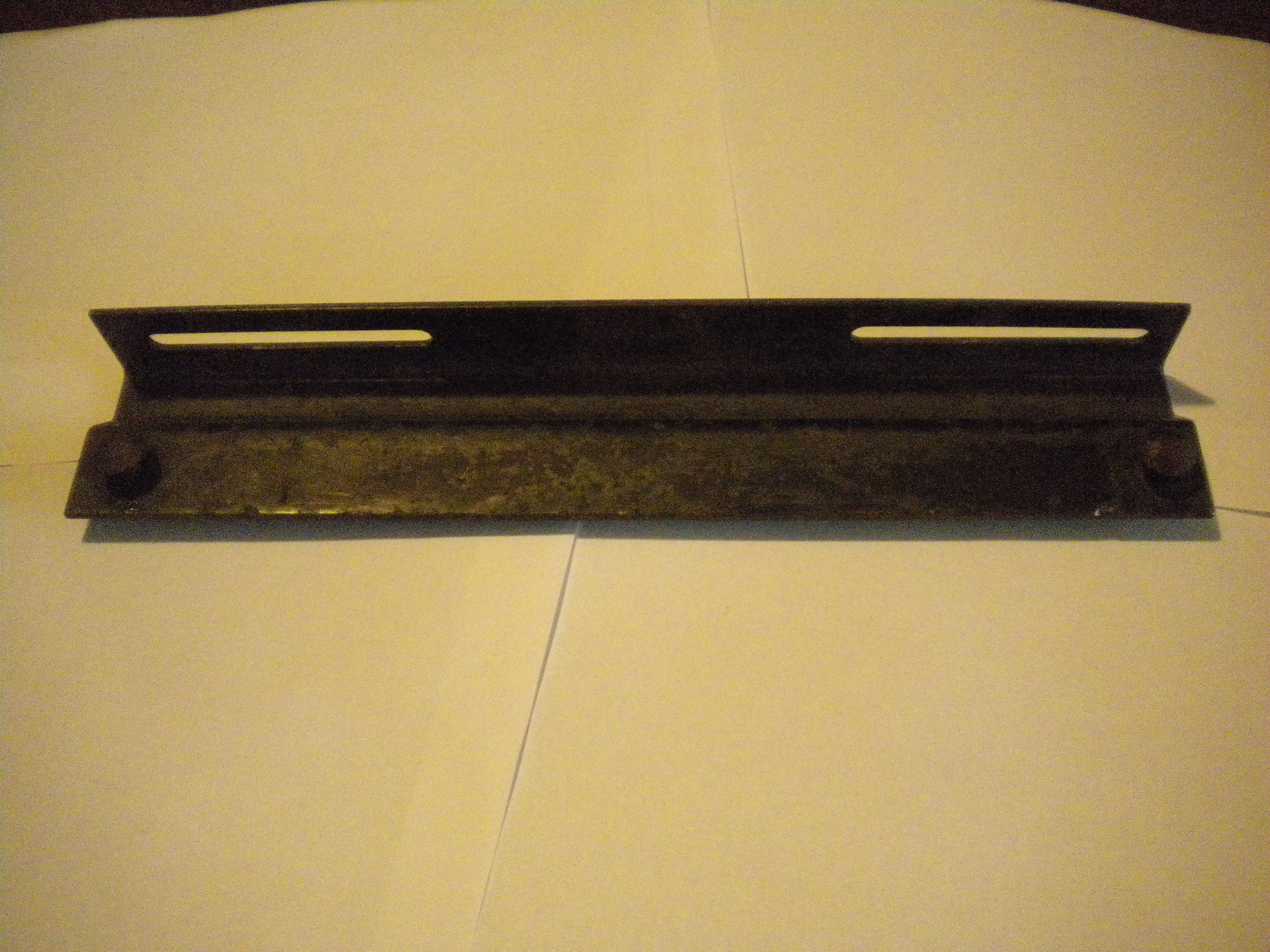

You ask about front tag bracket in your last thread.Just curious on what happen with info I gave you?

I found a used one. It is one piece with two mounting bolts. I will attach a picture of the one I found.
