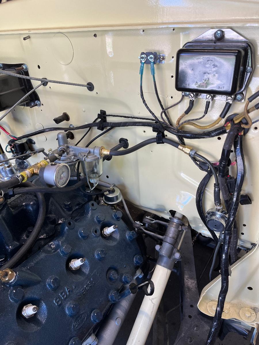

I am doing a 1948 Merc convertible with now an 8BA engine. Here is how my wiring harness is run through the firewall. You can see it is through a rubber grommet new the voltage reg. Hope this helps
al
