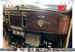

I did this 39 deluxe on a local car & it match the original wood grain under the windshield moldings. I used light brown walnut from grain it in Florida
