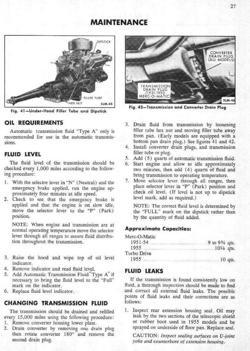

06-16-2021 @ 8:42 AM
Here is a page from the shop manual for the drain and fill procedure.
