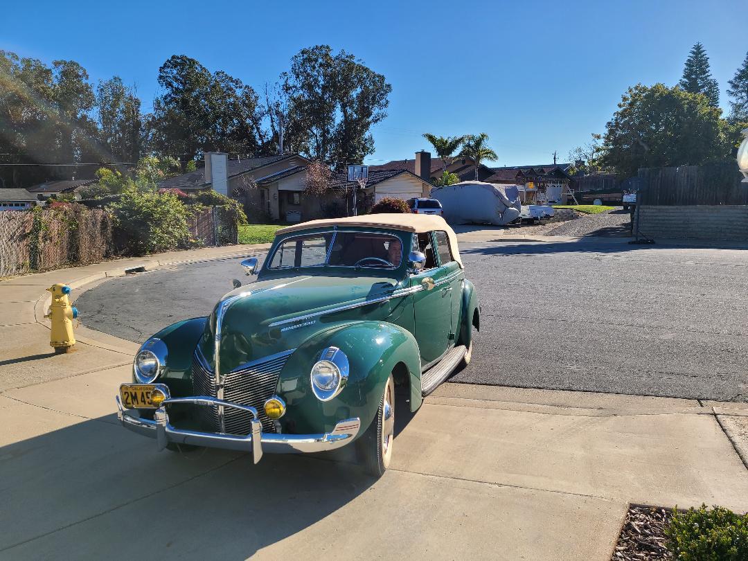

We are having Transmission problems. Not Shifting smoothly. We have drained the trans fluid and replace some bushings. Still Grinds and is hard to go shift into gear. Any Ideas on what it may be. Do we need to pull it and go threw it or does someone have any other ideas?

Very nice car. You don't see many Yosemite Green Mercurys
