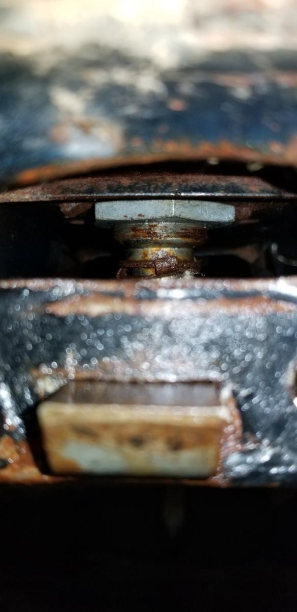

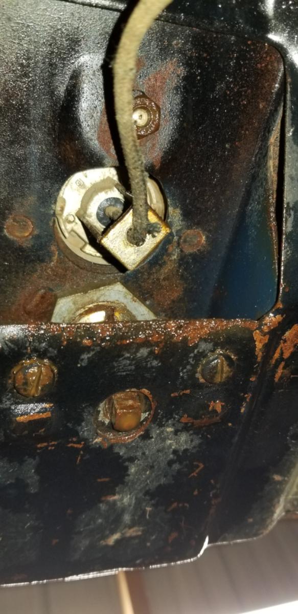

I have my great-grandparents' 41 Merc sedan. Until this year, it was last on the road in 1971. At some point before it was taken off the road, the trunk latch had quit working (evidenced by the fact that there is an old chunk of wood stuck in behind the latch that keeps the trunk from closing completely).
I'm not sure if the problem is that the lock is actually locked, and that disconnects something to prevent it from retracting the latch, or if there is a pin missing that should lock the latch shaft into the handle shaft. I would like to take the handle off to see ans well as clean and lube parts, but I can't see how to get a wrench in to loosen the retaining nut on the back of the handle. It looks like it's just about a 2" retaining nut, and the design of the door doesn't have a cover that can be taken off to access it. The only access is a 1" by just over 4" slot on the opposite side from the latch.
I've attached a couple images of the mechanism. The two screws visible when showing the latch shaft and the license plate light don't hold a cover. They appear to hold the latch assembly in place within the compartment.

Are you able to rotate the lock handle? Do you have an adjustable wrench which can accommodate a two inch nut? I would try to insert the wrench through the 1" x 4" slot and attempt to turn the retaining nut one 6th of a revolution at a time until it comes off. Once you have the nut off, the handle should come off. You might have to use some WD-40 or other penetrating oil to loosen it up.
08-21-2020 @ 9:10 AM
The handle will not rotate unless the key is in the lock and the lock is not locked. Trying to force it will damage the pot metal base for the handle. Removing the nut will allow the handle to be removed.
I believe that the nut on my 40 trunk handle is 1 1/8" and I think that your is the same. I will verify it later today.
It looks like you can get a straight shot at yours, but an adjustable wrench may be too thick.
If you cannot turn the key in the lock, squirt some penetrating oil in the lock and then insret and remove the key many times. Then try turning the key while moving the key up and down.

The trunk handle does rotate. I had it retracting the latch a couple times, but then I suspect my penetrating oil on the latch worked its way too far up and loosened whatever was allowing the handle shaft to grip the latch shaft.
The nut appears to be larger than 1 1/8". I have a crescent wrench that size, and it was a good bit larger than that.
08-22-2020 @ 10:11 AM
I measured the nut on my Mercury and it is 1 3/8" from flat to flat. Then I looked up the nut for your handle in the Standard Parts catalog and found a misprint and I agree that the nut must use a wrench size around 2 1/4". I doubt that an adjustable wrench, that will fit the nut, will fit in the space that you have to work in.
The P/N is 356162 -s7. 1 3/16"-24 special nut. It was used from 1941-1948 on both the Ford and Mercury.
The id of the nut is 1 3/16" and the book gives the od as 1 5/32".
My issue of the catalog is January, 1948. If someone has a different issue it may be correct in it.

Thank you for finding that. It at least gives me a definite size. Can you tell from the catalog if they made a special tool to get in there, or do I need to try to find a 2 1/4" open ended wrench and hope I have some room to turn the but?

You may be able to buy a "crows foot" wrench you can use to remove the nut. You may have to modify this wrench to get it to fit within the available space. A crows foot wrench is an open end wrench that has a provision for the insertion of a ratchet extension.
