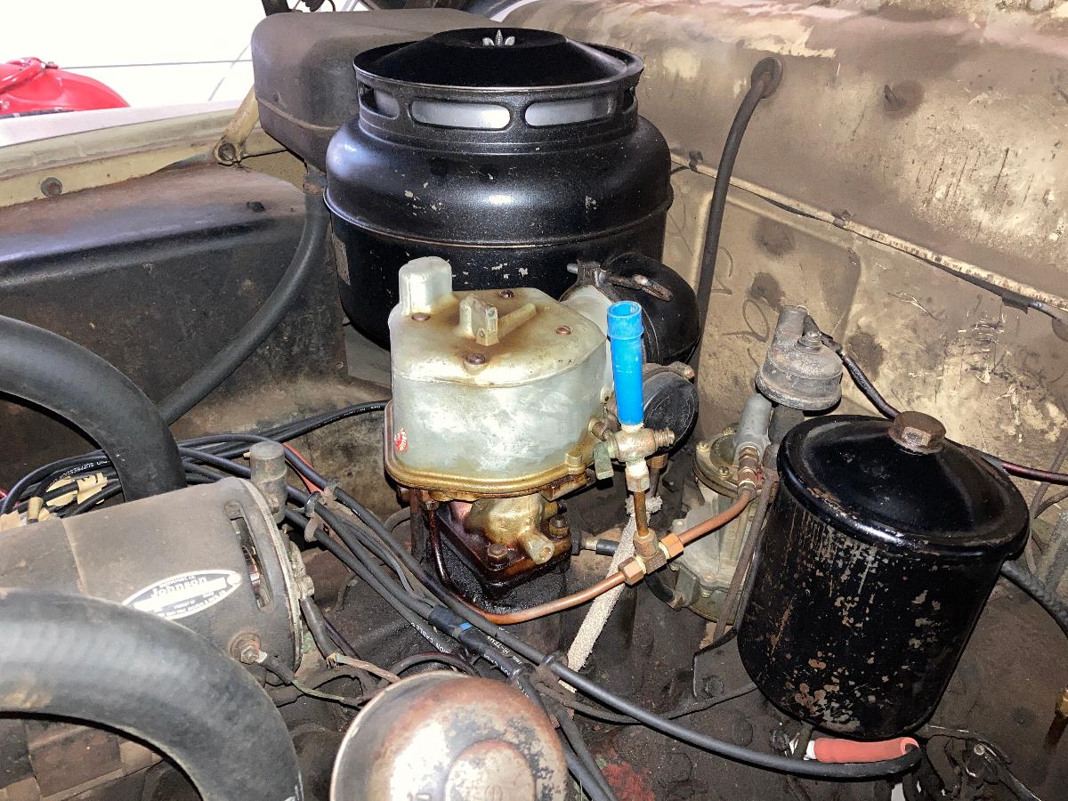

After a few "life events" I am back to getting my 1951 Merc 4 door sedan going. I drive it about 4 miles one Sunday a month. To start it I prime the carb using a "home-made" priming system (see photo)- a line spliced into the gas line near the carb which I carefully put gas in using a syringe. I understand a "common" problem is gas leaking/evaporating out of the carb after it sits a few days. My car will start quickly after 2 days of rest but not 3. Works Ok but I would like to get rid of the priming system so my son can start it easier/safer after I'm gone. The carb and fuel pump were installed in 1990 and the flexible fuel line in 2012. The glass bowl on the fuel pump stays full and the car runs good after I get it going, so is the fuel pump OK? Suggestions? THANKS!

leaking carburetor. by the photos you posted, it looks to me the carb seems to be leaking, but it been on there of 32 years if you start it everyday do you have the problem,? I would replace the flex line to start and see if that makes any difference, this may be the problem it is 30 years old, and is not made for the NEW GAS, same with the FUEL PUMP. the next would rebuild or have the fuel pump rebuilt, not replaced by a China part, any car sitting for a month with a carb would have issues, I had a 1980 Toyota truck and if sat for a week, it took many cranks to ge tit to start, but used eveyday had no problems, Hope this helps 37Ragtopman
