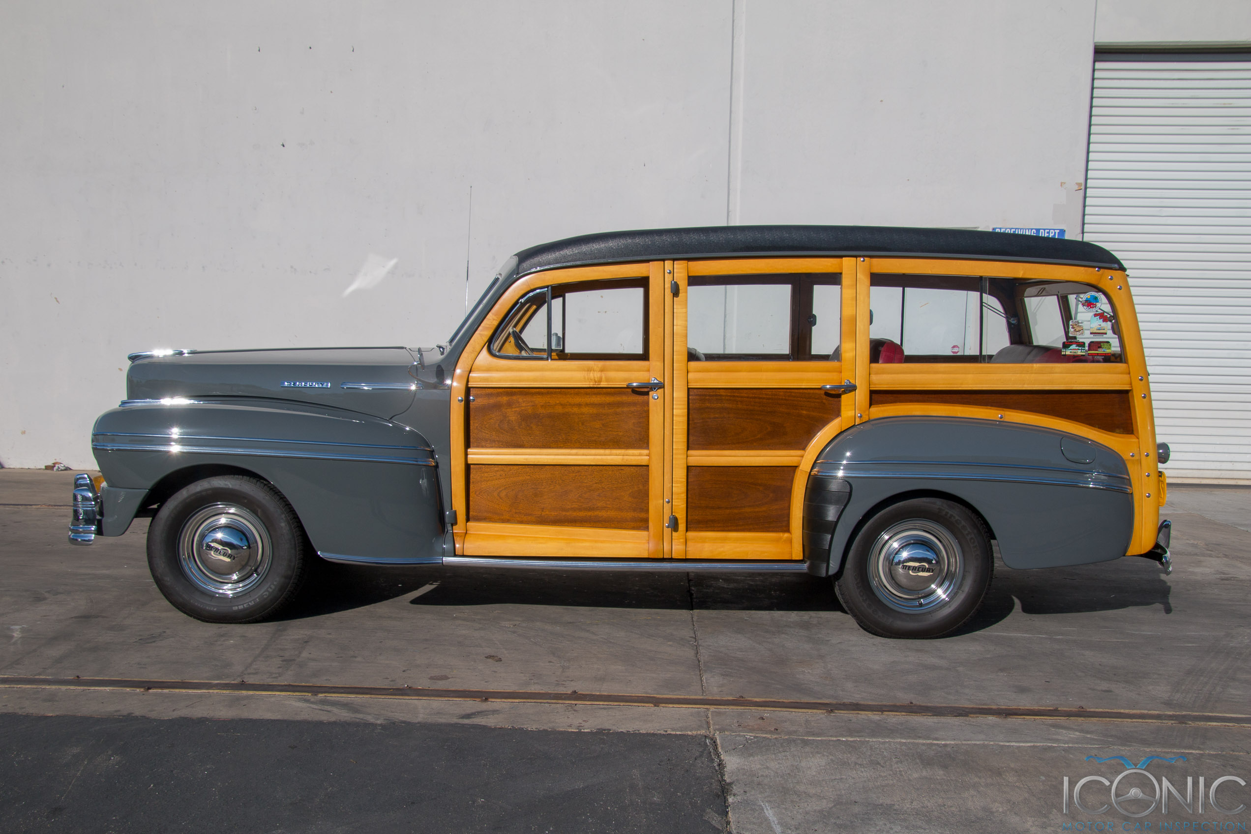

Here is a picture of my car for those interested.
11-19-2018 @ 7:32 AM
Thanks for the photo. That is a great looking station wagon.
