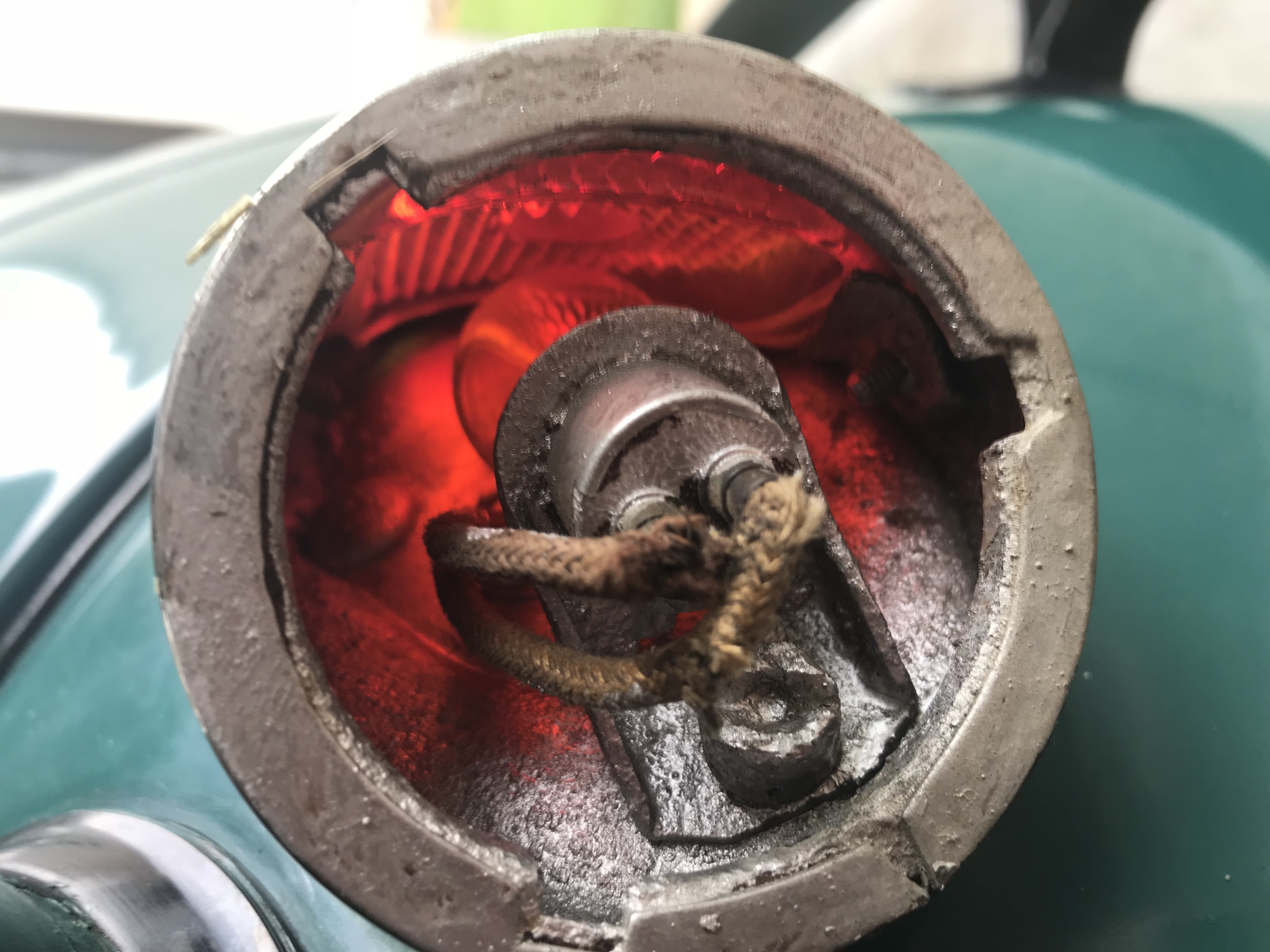

Tom, when i pull the end of the bezel off, this is what I see. The wires are old and fragile. I am assuming the the way to get the light changed is to loosen that little screw and pull the light out? I see the bulb inside and I bought new bulbs and a new pressure switch from bob drake. As it stands now, the brake lights work just fine when the car is running without power to the head and taillights, but when you turn the taillights on and depress the brake, there’s no change. I appreciate any help

Removing the rear facing lens will give you access to removing the bulb. The nut that is shown in your photo is quite rusty and may break if you try to remove it.
Before you remove the rear lens, try clipping a jumper wire to a good frame ground, such as the bolt that holds the bumper brace and touch the other end to the bulb housing, when the brake light and head lights are on. If the light gets brighter, you have a grounding problem and will have to find a way to remove that nut and clean the corrosion from the bracket and housing.
If the light does not get brighter, the bulb may be in upside down.
Maybe a 1939 Mercury owner will chip in with his experience with replacing the bulbs.

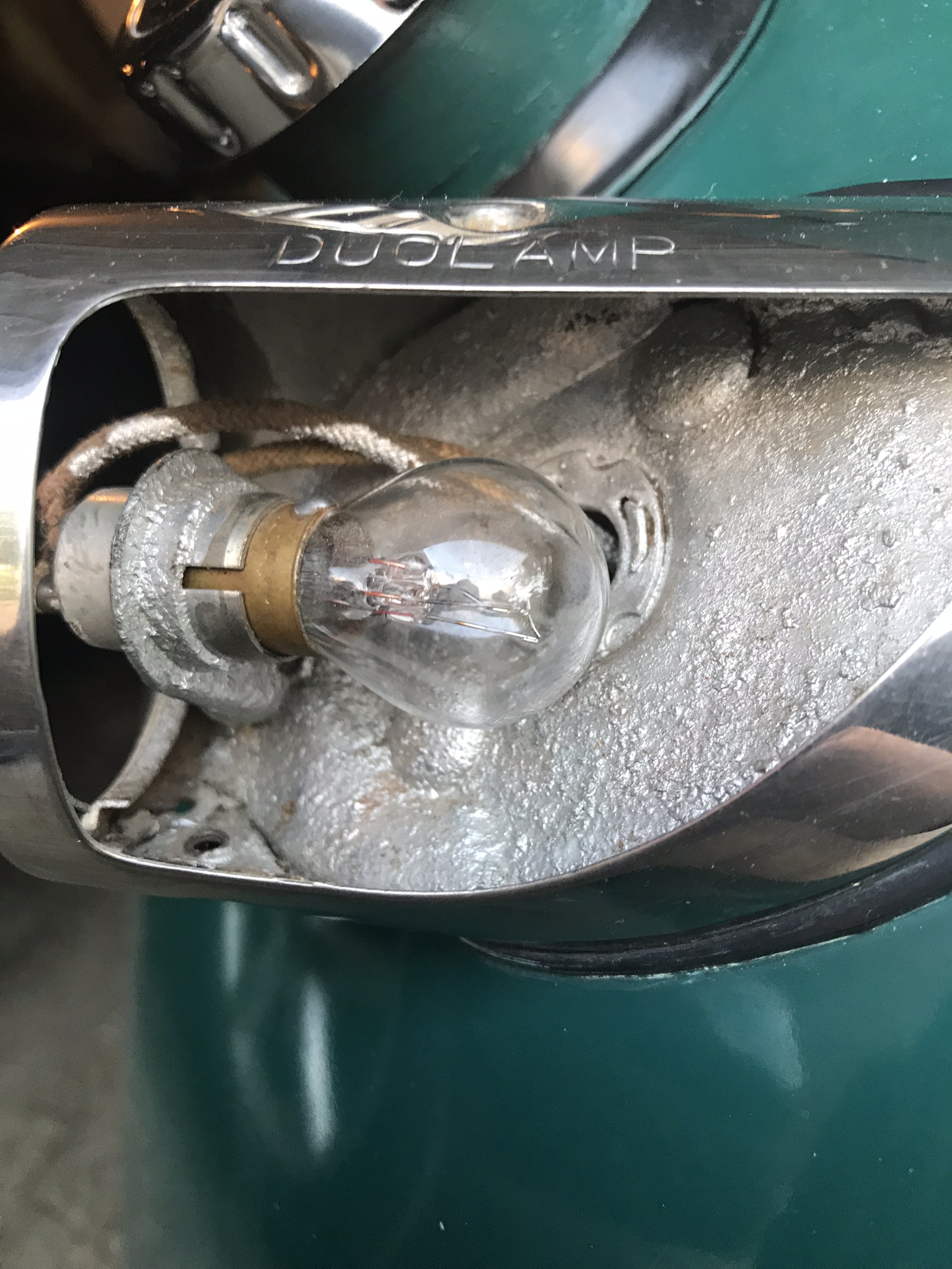

If needed, I have images that might help in removal of the lens to more easily access the lamp. Let me know (I would have attached them but I'm not sure how to do that.)

Yes please. I would appreciate the images

The attached image is pre-restoration and shows the larger (upper) bracket to hold the lens in place for the taillamp
