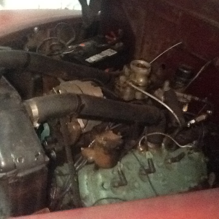

ok good to know, also a few months ago, the coil started leaking from the gasket , actually quit hot oil? wondering if I pry the cap of the coil can the nail screws be reused , what type liquid is used?

Replace the coil or send it out for rebuild. They are non serviceable.

It sounds like you may have an original Ford script coil. If this is the case, send it to Skip Haney in Florida to be rebuilt as it will fail and leave you stranded. His turnaround time is very fast.
http://www.fordcollector.com/coils.htm

For ph's benefit - noticed in the photo that an alternator has been installed in place of the original generator which begs several additional questions. Is it still positive ground? 6V or 12V? etc., etc. Clearly the coil shows a leak and indeed Skip Haney is the man for the rebuild as recommended above. This said, what information should ph provide to Skip or any other individual that may rebuild the coil concerning the car's modified/current configuration? What should ph verify about the car's current configuration and performance before installing the new coil (e.g., resistors, voltages, condenser, etc.)?
