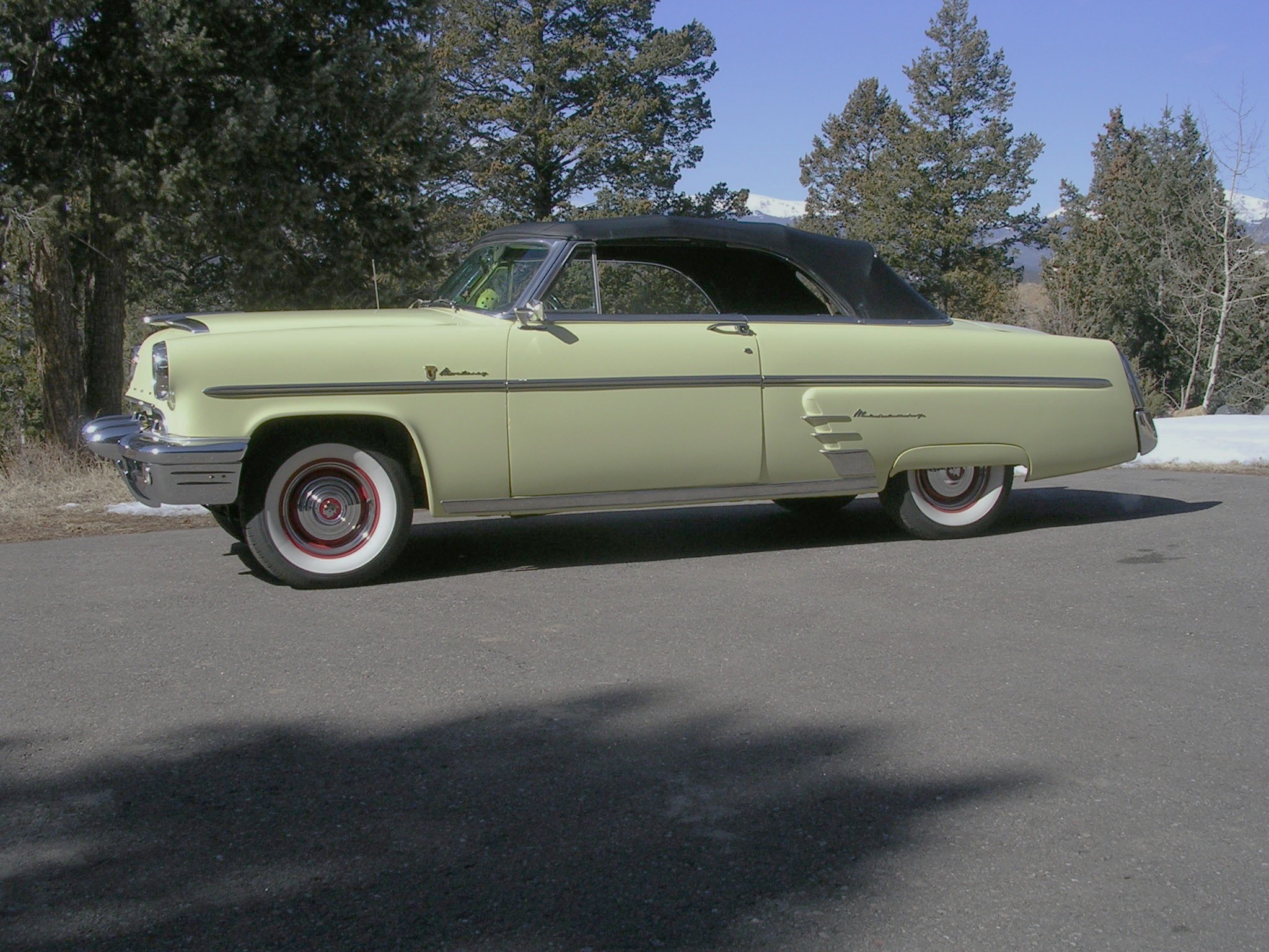

OK! What's the secret to keeping the full disc hubcaps on? They always seem to come loose, even had one pass me! Any help would be good. Stock 15"X5.5" wheels and Coker radials Stock hubcaps.
